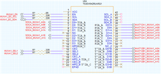

  • hi David,
    Below is my sch design for TS3DV642RUARQ1,would you please help review and answer my three questions :
    1,What is the VCC value if the 2lane MIPI CPHY voltage is 1.8V?
    2,How can I deal with the IIC interface-PIN3/4,PIN38/39/40/41,they all connect to SOC for configure,what is the pull up voltage-1.8V?Or IIC interface does not need?
    3,How can I set the mux IIC adress?
    Chengkai
  • Chengkai
    VCC is minimum of 3.0V and max of 3.6V. Typically VCC is 3.3V.
    IIC interface is to support HDMI DDC bus switching, they are not used for TS3DV642-Q1 configuration. TS3DV642-Q1 can only be configured through EN, SEL1, and SEL2 pin.
    3. The schematic itself look.
    David
