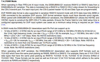

From the previous discussion about converting LVDS signal from an FCB camera that I learnt unable to implement, I came up with another idea about using an intermediate LVDS receiver to convert the signal to parallel as recommended by the camera vendor : Thine THC63LVD104C (that pairs with the LVDS transmitter inside the camera). Our newer problem to solve : how to convert the parallel output of the Thine THC63LVD104C to a more popular interface such as MIPI-CSI2, HDMI or USB3.0.
I saw in a related discussion about converting 12bit parallel to MIPI-CSI2 serializer and I wonder if I could do similarly : FCB camera (LVDS Tx) --> (LVDS Rx) Thine THC63LVD104C (10-bit Parallel) --> DS90UB913A-Q1/ DS90UB933-Q1 --> DS90UB954-Q1/ DS90UB936-Q1 --> (MIPI-CSI2 Rx) Application Processor.
