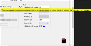

Also, can you tell me more about these notes in the Tuner? Right now we have a 207MHz in, Divisor of 3, 69MHz out. I have not seen this 621MHz requirement before?
Nice catch! Should be 4 DSI lanes. We no longer have the issue after correcting that

Also, if we were in non-burst mode where does this requirement come from? I can’t seem to find it described anywhere else but the DSI tuner.
What would happen if we were running at 207MHz and not 621MHz?

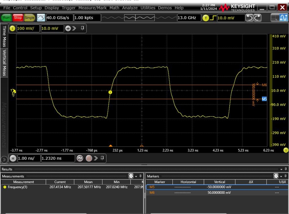

can you please advise on when/why we would want to adjust the equalization registers? I don’t think we have any signal integrity issues that would warrant it (see DSI signal at the bridge attached), but still wanted to get your thoughts?
This is just a recommendation and the device should operate fine if the recommended value is not used. As long as the timing spec for the panel/ desired resolution are met there is no issue with using a DSI clock of 207MHz.
The equalization that you want to use will simply apply a positive gain high pass filter across signal. The DSI data rate is not very fast with respect to other protocols such as HDMI and DP, so large dB equalization values are typically not necessary. Here are the registers that adjust the EQ for the clock and data.
There are only 2 settings for EQ on this device, so I would recommend testing both 1dB, 2dB, and no equalization and seeing which waveform has the largest margin in an eye diagram seen at the pins of the DSI84. That would be the ideal EQ value for your system.
