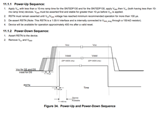

Hey Shinya,
I just want to make sure I understand the issue. The issue is a sporadic functional issue when the device is repeatedly rebooted. In this broken state there is no display and it seems that aux communication is broken. Is that correct?
If possible can you have a look at the the VCC, VDD, and RSTN timings and make sure that they fit within the device spec every time you reboot the device?
The issue may be that when rebooting multiple times the power-up/ power-down timings may be violated putting the device into an unknown state.
I noticed that HPD is held high when you power cycle, would you be able to hold HPD low and see if this issue goes away?

Since the power of the DP130 has not been operated, there is nothing to be confirmed about the power timing. If the low level is applied (approximately 150 ms) to the HPD during reboot while the power is still on, the event will not occur.

Hey Shinya,
What is your restart/ reboot procedure? Are you toggling EN?
ince there is no abnormality when the power is turned off and on, I tried to apply a low-pulse signal to the HPD terminal of the SN75DP130 at the time of restart,

Hey Shinya,
Can you send the waveforms of the power of the device? If the entire system is doing a restart I don't understand why the DP130 power is being held constant. Additionally, have you tried swapping this part out to see if the issue goes away?

So you see this aux failure on all devices, but the frequency of occurrences varies. Unfortunately, this device has a known issue regarding this, and the best solution would be to hold/ toggle HPD low for some time during reboot. As we have seen this resolves the issue. Let me know if I can do anything else.
