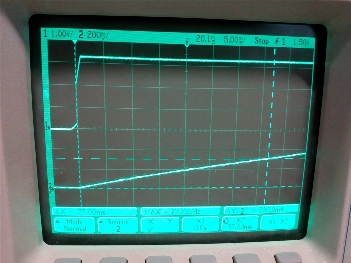

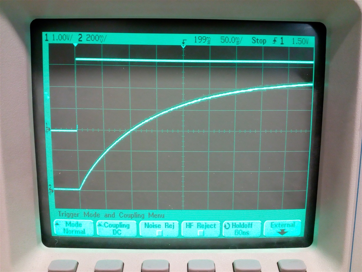

    Do you have a scope capture of the power cycling sequence?
    If VCC ramps up, RSTn being hold low for 400ms and then driven high, and then EN ramps up, do you still see this issue?
    David

  • I attached the requested scope images.
    I believe this rstn is in accordance with datasheet SLLSE57E.
    We really need a fix through some i2c register accesses as this decoder is in the field for several years already and we cannot make any board/bom changes at this point.
  • Bart
    Thanks for the scope capture and schematic.
    I did verify that this is an issue with couple flops inside the DP130 internal HPD controller being initialized to the wrong state during power up, and this in turn, produce an incorrect internal EN signal which would impact the AUX communication.
    The issue does not impact every DP130, only few units will be impacted by it.
    Unfortunately, the only workaround is to toggle the external HPD_SNK to clear this issue.
    David

    When this issue was initially debugged, we noticed that when the power up sequence is being properly followed, the good units will always be good units and bad units will always be bad units. So my expectation is that once the bad unit is being replaced, you will not see the issue again on that particular decoder.
