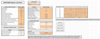

  • Yes, we are using REFCLK. Attached is a spreadsheet containing the register settings. The display requirements are also cited below.
    TI Support Bridge chip v1.xlsx
  • Hey I calculated the register values using the spreadsheet and our tool has different values. Try using the ones in this file:
    SN65DSI86_PANEL_VIDEOREGISTER_CALC_Augusto.xlsm

  • 0xF0 - 0xF8 all read 0x00 except for 0xF6 = 0x40, LOSS_OF_DP_SYNC_LOCK_ERR
  • Hmm yeah it seems that the sync timings are not lining up.
    Can you have a look at this and verify it is filled in properly for your system? I set the output type to RGB666 instead if RGB888 in the previous file. This is possibly why there are timing issues.
  • I had adjusted for the RGB666 to RGB888. Our timing is based on this:
  • Hmmm, can you confirm the DSI timings? From the looks of it the registers and ASSR are setup correctly for your panel, and this can be seen with the color bar. Meaning that the issue is stemming from the DSI inputs.
    Seeing as there is no PLL unlock it also means that the clock and speed of transmission is also ok. I think the best bet is to have a look at the DSI data and verify the line times, and then try swapping out the chip to see if that was the issue. It seems that you have everything set up correctly.

    single channel setup: SN65DSI86_PANEL_VIDEOREGISTER_CALC_Single_Theresa.xlsm
    dual-channel setup:SN65DSI86_PANEL_VIDEOREGISTER_CALC_Dual_Theresa.xlsm
  • Hi Vihesh,
    We are not using the crop registers, which are both zero. I can't use your spreadsheets as-is because we have an external 27MHz clock. In response to your question about what else changes when we switch to dual channel, I decided to generate a spreadsheet that compared the register settings in the files you provide above with the settings we're using in our code and the settings in the spreadsheets that we filled out (attached). Also, you had previously asked if we could look at MIPI signals. We have the ability to look at MIPI signals on an intermediate chip between the FPGA and the SN65DSI86, though the amount of video we can see on our scope at one time is limited. We have taken our board to another site to look at signals on a high speed scope and the signals and timing looked good. We have also switched GPIO 2 and 3 to outputs and looked at HSYNC and VSYNC on a scope, and those both looked good.
    Also, I tried even/odd, and the only difference was I stopped getting any errors (which appears to mean it's given up trying to interpret incoming video) even faster than normal.
    Theresa
    SN65DSI86 register comparison_Collins_2024-04-29.xlsx
