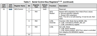

    We Compared the black screen and before black screen register, the 0x1d, 0x1e, 0x35 & 0x3b of DS90UB928Q-Q1 is charged,
    and we check the register of 0x35 & 0x3b,please advise if this is the AEQ issue?
    If the 928 registers weren't returning to their default values, this might be an AEQ issue. When the 928 is reset, it will not always return to the same AEQ value.
