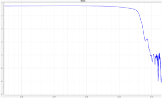

    I setup the S-parameter myself, and you have the correct port configuration (port1/2 = A+/-, port 3/4 = C+/-). Which waveform are you looking at in particular?
    For example, this waveform S [4,2] shows the insertion loss between C- and A-. Is this the waveform you're referring to?

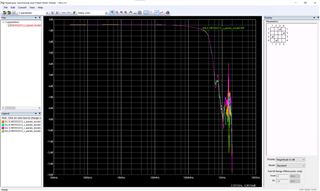

  • HI Shane,
    Thanks for your reply,
    Yes, the Insertion loss you have shown is the one I am referring too.
    And I use the same ports for LineSim in Hyperlynx, my USB waveforms doesn't seem to be good as below.
    Can you please help me on this? And more over If I use only the driver without MUX my waveform is within the USB Eye pattern.

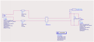

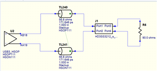

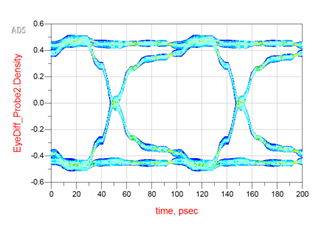

  • Hi Rajesh,

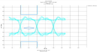

    Thank you for your patience. I re-created your setup in Keysight ADS to try and reproduce the issue:
    When I run the simulation, I get the following Eye diagram:
    The eye diagram I saw on ADS looks better then the one you have. We only use ADS for simulations, so I'm not sure whether Hyperlynx is interfering with the s-parameter file in some way.
    Just to confirm, does the simulation setup I made accurately reflect your system?

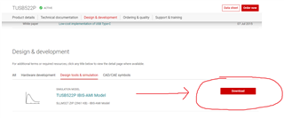

  • Hi Rajesh,
    Here's the .ibs mode for that part:
    RX_generic.ibs
    I based my simulation on the IBIS model for the TUSB522P. This model includes the RX_generic.ibs and TX_generic.ibs files.
    I hope this helps, let me know if you have any questions.
    Shane

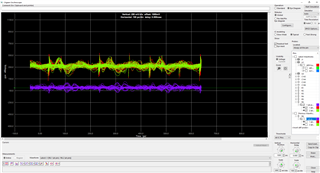

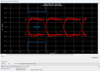

  • Hi Shane,
    I tried your configuration in Hyperlynx, but I couldn't see the results.
    If I run the S-Parameters in Hyperlynx touchstone these are the below results:
    If I use the same as above touchstone configuration below are the results:
    If run without HD3SS MUX, just simulating only the driver, below is the result:
    Can you please help me on this issue?

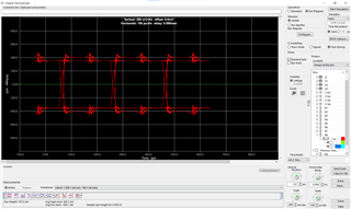

  • Hi Shane,
    I have tried to simulate the HD3SS3220: HD3SS3220-TX-to-TX2.s4p s-parameter fine, I am able to see the results without any issue as below.
    Can you please let me know how to simulate with HD3SS3212 s-parameter file.

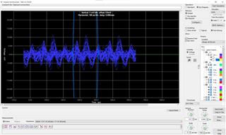

  • Hi Brian,
    If I simulate the USB below is how the simulation result look like on either pin of the differential pair,
    Signal is either above origin or below origin. Can you please help me in correcting this.
    I am using AC Coupling Capacitors in series.
    BR,
    Rajesh G.
  • Did you get right port?
    port 1 and 3 is differential port 1, port 2 and 4 is differential port2.
    brian

  • If I am using AC Coupling Capacitor, I am seeing the shift in the DC bias point, how to correct that Shift?
    In the Above simulation results you can see 1 diff pair simulations at 2 points, there is offset to either positive or negative side. How to correct that?
    BR,
    Rajesh G.
  • it seems like single ended P and N signal.  Differential  output should be just one signal.
    Did you compare  with HD3SS3220?
    brian
  • Hi Brain,
    I have found a solution, I need to enable a setting in Hyperlynx to settle the AC Coupling Capacitors connected in series before simulations.
    Below is the waveform of my design:
    BR,
    Rajesh G
  • Glad it works, why it didn't  crossed at 0v?
    Best
    brian
  • There is some offset, working on it to solve. Will get back to you if any help required.
