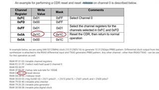

I looked at the CDR reset procedures in the programming guide and in one of your link on the forum. There are some differences and I would like to clarify them.
The procedure described in the programming manual (page 52) consists of:
RAW 0A 1C 1C // reset device
RAW 0A 00 1C // reset - release
That is, bits 2-4 of register 0x0A are first set to “1” and then reset to “0”.
The procedure described on the forum is different - the mask 0x0C is used, not 0x1C. That is, bit 4 of register 0x0A is not involved in the CDR-reset procedure.
Please tell me which option is correct.
P.S. I am attaching a screenshot with a description. Tell me please, do you see my screenshots? I don't see them in our correspondence.
TI-CSC
  • Hi TI-CSC,
    It looks like there is a mistake in the programming guide. The correct procedure to perform a CDR reset is the following.
    (channel register, write value, mask)
    0x0A 0x0C 0x0C // place device in reset state
    0x0A 0x00 0x0C // release reset
    Note that bit 3 is an enable bit to override CDR reset with 0x0A[2]. Therefore, CDR reset can be released by writing (0x0A 0x08 0x0C) or (0x0A 0x00 0x0C).
