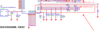

Hello:

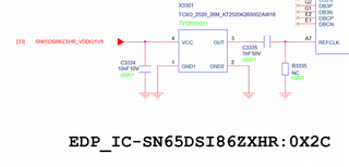

Problem description: During the production process of the production line, MIPI to EDP screen did not display. After powering off and turning on again, there is still no display.
Problem analysis:
1. The power on timing of SN65DSI86ZXHR meets the requirements of the specifications.
2. Measure the waveform of the external crystal oscillator at 26M. Does it meet the requirements? (Test DC, 1M Ω gear)

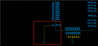

3. Design principle diagram of external clock
4. Crystal oscillator input, AC or DC. What is the minimum level that needs to be reached?

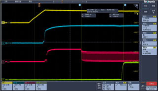

5. Signal waveform of C3335 replaced with 0 Ω resistance test

  • Hello Vishesh:
    This is a routine troubleshooting that cannot light up, but the customer now wants to know if there is a problem with the capacitor isolated AC input when using TCXO for the external clock, and if it is safer to change it to a series resistor with bias input?
    The customer previously used SN65DSI86ZQER, and the circuit diagram is shown in the red box below,
    Due to the discontinuation of this material, SN65DSI86ZXHR has been used instead. The circuit diagram is shown below. Please help confirm if it is reasonable. Thank you!!!
  • Try removing the series cap and replacing it with a resistor.
    This is the TI implementation from the DSI86-EVM
  • Hello Vishesh:
    May I ask again

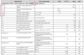

    1. When using an external crystal oscillator, is the input signal AC or DC? How is the amplitude required?

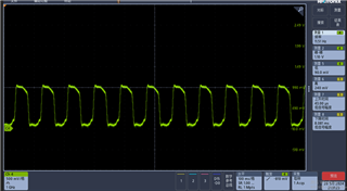

    2. The following image shows a waveform that has been replaced with 0 Ω. Could you please help troubleshoot if there is any problem?
    3 If the external crystal oscillator is not attached and the software configuration uses an external crystal oscillator, can the chip work normally? Or will it try to lock frequency from MIPI CLK?
  • Hey Jimmy,
    The input signal should be DC coupled. The amplitudes require can be found in the datasheet:
    Looks like the frequency of the clock is 11.51Hz.

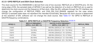

    The required frequencies for the REFCLK are 12MHz, 19.2MHz, 26 MHz, 27 MHz, and 38.4MHz.
    If there is no REFCLK and the software is configured for external clock the chip will not function normally. You will need to configure the chip to use the DSI clock. However, there are only certain frequencies of DSI clock that will work with the PLL so using REFCLK is recommended.
  • Hello Vishesh:
    The customer is currently facing a problem: when there is an external crystal oscillator, the software 0A register is configured to fetch clk from the external crystal oscillator, and the 0A register is read as 0x84. However, the customer intentionally removed the external crystal oscillator on the hardware, and the software still writes 0A as 0x04, but the actual read is 0x05. Has this IC been automatically updated? Is this a normal phenomenon?
  • The DSI86 shouldn't have an internal update for any registers other than the error registers this is not a normal phenomenon. What else is on the I2C line that could write to the DSI registers?
  • Hello Vishesh:

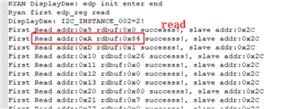

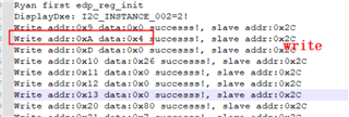

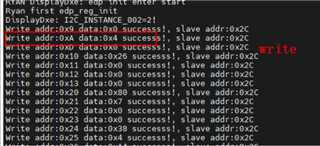

    The customer has currently conducted the following black screen experiments
    Prerequisite: The TI chip is connected to an external crystal oscillator of 26M, and the software 0X0A is configured with an external crystal oscillator of 0X04
    1. Normal startup
    Write 0X0A register as 0X04
    Read 0X0A as 0X84

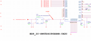

    2. On the basis of step 1, measure the waveform of the external clock at the following positions
    1) Under normal startup in step 1, when the oscilloscope probe points to the position shown in the picture, a black screen appears and the image is not displayed
    2) When the oscilloscope probe is still in this position and not released, the device is powered off and restarted. The device goes black and does not display an image. The waveform of the crystal oscillator is normal. At this time, when grabbing the register log, it is found that the value of the 0X0A register has changed to 0X05, as shown in the following figure

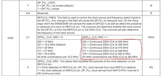

    Question:
    1、Why does the oscilloscope probe contact the above test points and change the register value of 0x0A?
    2、What is the basis for judging whether clk is normal with register 0x0A?

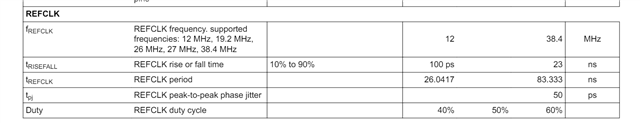

    Are they using a passive or an active probe to probe the oscillator input?
    Below is the REF_CLK spec,
    DSI86 will support 26MHz, and DP_PLL_LOCK bit of register 0x0A will go high if DSI86 detects a valid clock input.
    David

    MDP_DataPartitionInit: splash PartitionFound=1
    Setvariable returned Success
    Ryan FsBlkBuffer = 31,31,31,31,0,0,0,Status= 0,EFI_SUCCESS =0,len=4096
    Ryan ReadSsignChar Panel_Info =1111
    display>>>Panel_Default_PowerUp pull up gpio102 for enable avdd start
    display>>>Panel_Default_PowerUp pull up gpio102 for enable avdd stop
    display>>>Panel_Default_PowerUp pull up gpio100 for enable avdd start
    display>>>Panel_Default_PowerUp pull up gpio100 for enable avdd stop
    display>>>Panel_Default_PowerUp pull up gpio35 for enable reset start
    display>>>Panel_Default_PowerUp pull up gpio35 for enable reset stop
    display>>>Panel_Default_PowerUp pull up gpio97 for enable avdd start
    display>>>Panel_Default_PowerUp pull up gpio97 for enable avdd stop
    display>>>EDP VCC 12V pull up gpio111 for enable avdd start
    display>>>EDP VCC 12V pull up gpio111 for enable avdd stop
    Ryan panel flag =0
    RYAN DisplayDxe: edp init enter start
    Ryan first edp_reg_init
    DisplayDxe: I2C_INSTANCE_002=2!
    Write addr:0x9 data:0x0 successs!, slave addr:0x2C
    Write addr:0xA data:0x9 successs!, slave addr:0x2C
    Write addr:0xD data:0x0 successs!, slave addr:0x2C
    Write addr:0x10 data:0x26 successs!, slave addr:0x2C
    Write addr:0x11 data:0x0 successs!, slave addr:0x2C
    Write addr:0x12 data:0x5C successs!, slave addr:0x2C
    Write addr:0x13 data:0x5C successs!, slave addr:0x2C
    Write addr:0x20 data:0x80 successs!, slave addr:0x2C
    Write addr:0x21 data:0x7 successs!, slave addr:0x2C
    Write addr:0x22 data:0x0 successs!, slave addr:0x2C
    Write addr:0x23 data:0x0 successs!, slave addr:0x2C
    Write addr:0x24 data:0x38 successs!, slave addr:0x2C
    Write addr:0x25 data:0x4 successs!, slave addr:0x2C
    Write addr:0x2C data:0x14 successs!, slave addr:0x2C
    Write addr:0x2D data:0x0 successs!, slave addr:0x2C
    Write addr:0x30 data:0x8 successs!, slave addr:0x2C
    Write addr:0x31 data:0x0 successs!, slave addr:0x2C
    Write addr:0x34 data:0xA0 successs!, slave addr:0x2C
    Write addr:0x36 data:0x1B successs!, slave addr:0x2C
    Write addr:0x38 data:0x64 successs!, slave addr:0x2C
    Write addr:0x3A data:0x14 successs!, slave addr:0x2C
    Write addr:0x3C data:0x0 successs!, slave addr:0x2C
    Write addr:0x3D data:0x0 successs!, slave addr:0x2C
    Write addr:0x3E data:0x0 successs!, slave addr:0x2C
    Write addr:0x5B data:0x1 successs!, slave addr:0x2C
    Write addr:0x93 data:0x64 successs!, slave addr:0x2C
    Write addr:0x94 data:0x81 successs!, slave addr:0x2C
    Write addr:0x5C data:0x1 successs!, slave addr:0x2C
    Write addr:0x5A data:0x5 successs!, slave addr:0x2C
    Write addr:0xD data:0x1 successs!, slave addr:0x2C
    Write addr:0x64 data:0x1 successs!, slave addr:0x2C
    Write addr:0x74 data:0x0 successs!, slave addr:0x2C
    Write addr:0x75 data:0x1 successs!, slave addr:0x2C
    Write addr:0x76 data:0xA successs!, slave addr:0x2C
    Write addr:0x77 data:0x1 successs!, slave addr:0x2C
    Write addr:0x78 data:0x81 successs!, slave addr:0x2C
    Write addr:0x96 data:0x1 successs!, slave addr:0x2C
    Write addr:0x5A data:0xD successs!, slave addr:0x2C
    RYAN DisplayDxe: edp init enter end
    RYAN DisplayDxe: edp read enter start
    Ryan edp_reg_read
    First Read addr:0x9 rdbuf:0x0 successs!, slave addr:0x2C
    First Read addr:0xA rdbuf:0x9 successs!, slave addr:0x2C
    First Read addr:0xD rdbuf:0x1 successs!, slave addr:0x2C
    First Read addr:0x10 rdbuf:0x26 successs!, slave addr:0x2C
    First Read addr:0x11 rdbuf:0x0 successs!, slave addr:0x2C
    First Read addr:0x12 rdbuf:0x5C successs!, slave addr:0x2C
    First Read addr:0x13 rdbuf:0x5C successs!, slave addr:0x2C
    First Read addr:0x20 rdbuf:0x80 successs!, slave addr:0x2C
    First Read addr:0x21 rdbuf:0x7 successs!, slave addr:0x2C
    First Read addr:0x22 rdbuf:0x0 successs!, slave addr:0x2C
    First Read addr:0x23 rdbuf:0x0 successs!, slave addr:0x2C
    First Read addr:0x24 rdbuf:0x38 successs!, slave addr:0x2C
    First Read addr:0x25 rdbuf:0x4 successs!, slave addr:0x2C
    First Read addr:0x2C rdbuf:0x14 successs!, slave addr:0x2C
    First Read addr:0x2D rdbuf:0x0 successs!, slave addr:0x2C
    First Read addr:0x30 rdbuf:0x8 successs!, slave addr:0x2C
    First Read addr:0x31 rdbuf:0x0 successs!, slave addr:0x2C
    First Read addr:0x34 rdbuf:0xA0 successs!, slave addr:0x2C
    First Read addr:0x36 rdbuf:0x1B successs!, slave addr:0x2C
    First Read addr:0x38 rdbuf:0x64 successs!, slave addr:0x2C
    First Read addr:0x3A rdbuf:0x14 successs!, slave addr:0x2C
    First Read addr:0x3C rdbuf:0x0 successs!, slave addr:0x2C
    First Read addr:0x3D rdbuf:0x0 successs!, slave addr:0x2C
    First Read addr:0x3E rdbuf:0x0 successs!, slave addr:0x2C
    First Read addr:0x5B rdbuf:0x1 successs!, slave addr:0x2C
    First Read addr:0x93 rdbuf:0x64 successs!, slave addr:0x2C
    First Read addr:0x94 rdbuf:0x81 successs!, slave addr:0x2C
    First Read addr:0xC2 rdbuf:0xF successs!, slave addr:0x2C
    First Read addr:0x5A rdbuf:0xD successs!, slave addr:0x2C
    First Read addr:0x64 rdbuf:0x1 successs!, slave addr:0x2C
    First Read addr:0x74 rdbuf:0x0 successs!, slave addr:0x2C
    First Read addr:0x75 rdbuf:0x1 successs!, slave addr:0x2C
    First Read addr:0x76 rdbuf:0xA successs!, slave addr:0x2C
    First Read addr:0x77 rdbuf:0x1 successs!, slave addr:0x2C
    First Read addr:0x78 rdbuf:0x81 successs!, slave addr:0x2C
    First Read addr:0x96 rdbuf:0x1 successs!, slave addr:0x2C
    First Read addr:0xF0 rdbuf:0x0 successs!, slave addr:0x2C
    First Read addr:0xF1 rdbuf:0x0 successs!, slave addr:0x2C
    First Read addr:0xF2 rdbuf:0x0 successs!, slave addr:0x2C
    First Read addr:0xF3 rdbuf:0x0 successs!, slave addr:0x2C
    First Read addr:0xF4 rdbuf:0x0 successs!, slave addr:0x2C
    First Read addr:0xF5 rdbuf:0x0 successs!, slave addr:0x2C
    First Read addr:0xF6 rdbuf:0x0 successs!, slave addr:0x2C
    First Read addr:0xF7 rdbuf:0x0 successs!, slave addr:0x2C
    First Read addr:0xF8 rdbuf:0x0 successs!, slave addr:0x2C
    First Read addr:0xFF rdbuf:0x0 successs!, slave addr:0x2C
    RYAN DisplayDxe: edp read enter end
    display>>>BOE EDP bl pull up gpio31 for enable avdd start
    display>>>boe EDP bl pull up gpio31 for enable avdd stop
    display>>> pull up gpio30 for enable led key
    ====Read panel id from ID's register,readsize=8===
    00,00,00,00,00,00,00,00,
    =====Get panel id from panellist=======
    11,00,00,00,00,00,00,00,
    Dynamic-Detected panel Failed
    DisplayDxe: Resolution 1920x1080 (1 intf)
    LoadImageFromPartitionUsingGuid Failed: 14
    MinidumpTALib:LoadImageFromPartition(mdcompress) failed: 0xNot Found
    MinidumpTADxe: Minidump TA loading failed.
    Disp init wait [ 2125]
    DisplayDxe: Panel_Default_Brightness_Enable: Getting PMIC mode failed with error(4), power configuration Failed!
    Platform Init  [ 2370] BDS

  • Hey Jimmy,
    Can you show a waveform of the refclk at the frequency needed by the DSI86?

       <i2c_write addr="0x2D" count="0" radix="16">0A</i2c_write> <sleep ms="10"/>
       <i2c_read addr="0x2D" count="2" radix="16">00</i2c_read> <sleep ms="10"/>
    ======Semi-Auto TRAIN ======
       <i2c_write addr="0x2D" count="1" radix="16">96 0A</i2c_write> <sleep ms="20"/>
    ======ADDR 0x0A CFR======
       <i2c_write addr="0x2D" count="0" radix="16">96</i2c_write> <sleep ms="20"/>
    ======Read======
        <i2c_read addr="0x2D" count="1" radix="16">00</i2c_read> <sleep ms="10"/>
    =====CHA_ACTIVE_LINE_LENGTH=======
        <i2c_write addr="0x2D" count="2" radix="16">20 00 04</i2c_write> <sleep ms="10"/>
    =====CHA_VERTICAL_DISPLAY_SIZE=======
        <i2c_write addr="0x2D" count="2" radix="16">24 58 02</i2c_write> <sleep ms="10"/>
    =====CHA_SYNC_DELAY=======
        <i2c_write addr="0x2D" count="2" radix="16">28 00 00</i2c_write> <sleep ms="10"/>
    =====CHA_HSYNC_PULSE_WIDTH=======
        <i2c_write addr="0x2D" count="2" radix="16">2C 80 80</i2c_write> <sleep ms="10"/>
    =====CHA_VSYNC_PULSE_WIDTH=======
        <i2c_write addr="0x2D" count="2" radix="16">30 04 80</i2c_write> <sleep ms="10"/>
    =====CHA_HORIZONTAL_BACK_PORCH=======
        <i2c_write addr="0x2D" count="1" radix="16">34 28 </i2c_write> <sleep ms="10"/>
    =====CHA_VERTICAL_BACK_PORCH=======
        <i2c_write addr="0x2D" count="1" radix="16">36 09</i2c_write> <sleep ms="10"/>
    =====CHA_HORIZONTAL_FRONT_PORCH=======
        <i2c_write addr="0x2D" count="1" radix="16">38 28</i2c_write> <sleep ms="10"/>
    =====CHA_VERTICAL_FRONT_PORCH=======
        <i2c_write addr="0x2D" count="1" radix="16">3A 01</i2c_write> <sleep ms="10"/>
    =====DP_18BPP_EN =======
      <i2c_write addr="0x2D" count="1" radix="16">5B 01 </i2c_write> <sleep ms="100"/>
    =====COLOR BAR =======
        <i2c_write addr="0x2D" count="1" radix="16">3C 10</i2c_write> <sleep ms="100"/>
    ======enhanced framing and Vstream enable======
      <i2c_write addr="0x2D" count="1" radix="16">5A 0C </i2c_write> <sleep ms="100"/>
    ======DUMP CFR======
        <i2c_write addr="0x2D" count="0" radix="16">20</i2c_write> <sleep ms="10"/>
    ======Read======
        <i2c_read addr="0x2D" count="32" radix="16">00</i2c_read> <sleep ms="10"/>
    </aardvark>
  • Hello Vishesh:
    Thank you for your feedback!!!
    Customer has another question. If it is to be designed as an internal crystal oscillator, what is the design of this part?Thanks!!!
  • Hey Jimmy,
    The way to design this can be found in thedatasheet.
    This step can be bypassed by I2C registers as well:
    If GPIO selection of REFCLK or DACP/N frequency is not used, then software must program the REFCLK_FREQ, CHA_DSI_CLK_RANGE and CHB_DSI_CLK_RANGE through the I2C interface prior to issuing any DSI commands or packets to the SN65DSI86.
