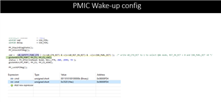

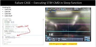

We are using TPS6538 n with INH in high impedance state we send STBY cmd to PMIC ...While doing so INH or STB pin of TCAN starts toggling which does not ket PMIC to go sleep
Any suggestions?

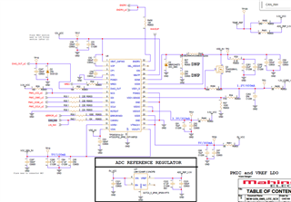

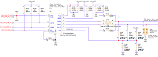

    I am using the below circuit config - Need your review feedback on hardware perpective.
    - Can you please let me know how can i check POR on VSUP is not happening. the thresold values for POR and how it is going to impact INH pin.

    From the first picture of the waveforms you provided above, I'm not seeing POR on VSUP, but nSTB is not pulling LOW so the device doesn't enter the sleep mode, that's why INH is not turned off here.

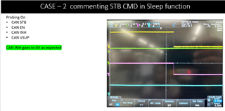

    Your second picture shows nSTB is LOW while EN is High, so the transition to sleep mode is performed, INH also turned off as expected.
    As Eric said, we couldn't comment on what cause nSTB not going to LOW, this is an input pin from microcontroller and the transceiver is not able to control the digital input level.
    Since the application is using TI's MCU, I would recommend to contact the EP team (ASM-AUTO) for their helping to check your codes.
