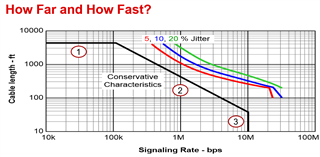

    From a capacitive sense vs frequency/data rate. They should be able to support around 20Mbps if you're okay with 5% jitter
    For region 2, it's based on the jitter/AC response. From a cabling perspective, generally we assume about 50pF per meter so this gives you a rough estimate on the capacitive loads RS 485 devices can drive.(dependent on frequency/datarate). So the capacitance it supports varies with the data rate at higher speeds over 100kbps.
    Region 1 looks at the DC response (DC resistance) so you can use this to approximate cable resistance as well. (maybe around 18ohms per 1000 Ft or close to 60 ohms at 1kM). So at 1 kM you will have an attenuation of about half your sent signal at the received side. (60 ohm total termination with 60 ohm series resistance).
