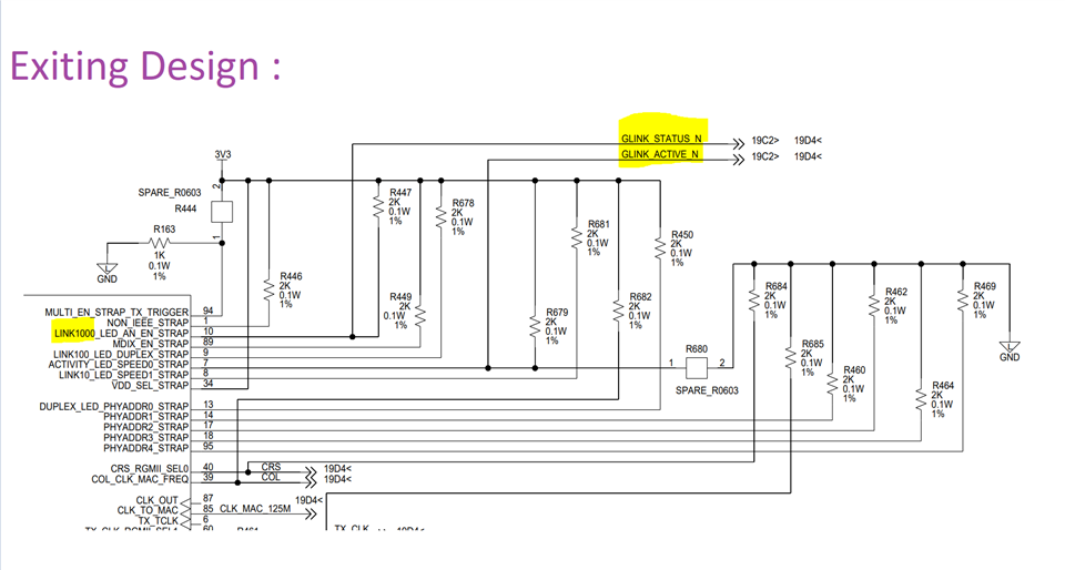

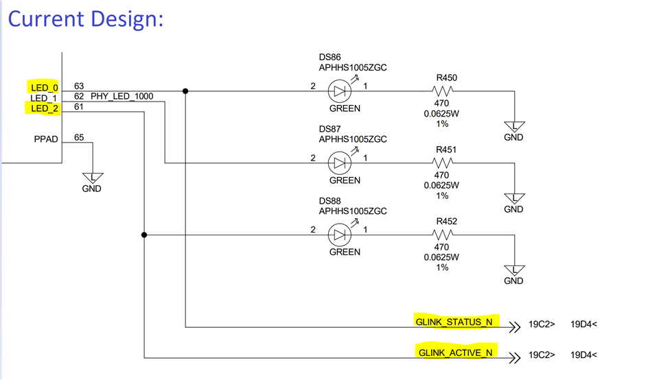

I am reaching out regarding a potential transition in our hardware design from the DP83865 Ethernet chip to the DP83867IR. As part of our product development process, we need to ensure that this transition is seamless and that the DP83867IR is a suitable replacement for our current requirements.
Could you please provide assistance in confirming whether the DP83867IR can serve as a one-to-one replacement for the DP83865 in our application?

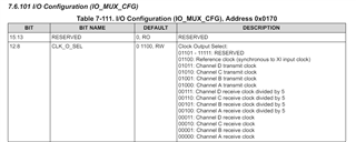

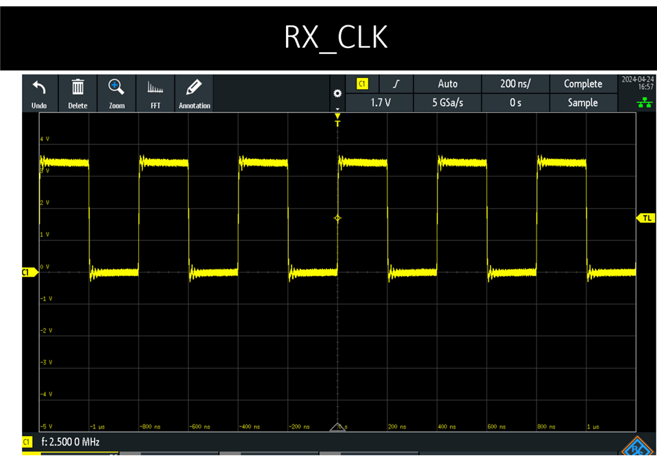

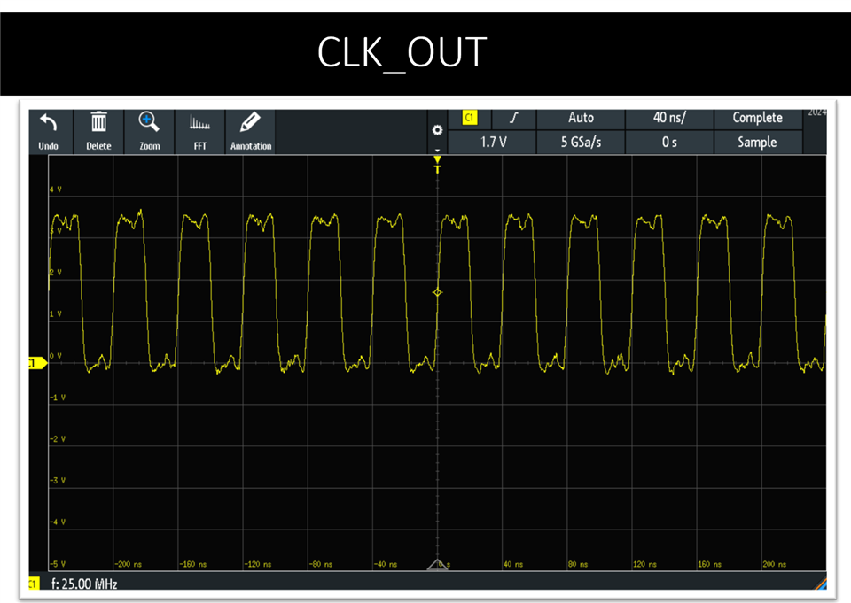

"Additionally, we have attached the GMII Mode Clarification Report Excel sheet. Kindly review it and provide your feedback."
Our project details are as follows:
 Current Ethernet Chip: DP83865
Proposed Replacement: DP83867IR
Thanks ,
Pavithran G
 GMII mode_Clarification report.xlsx
