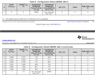

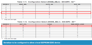

Team,
my customer ( in bcc ) wants to use a local EEPROM to store the EDID that will be loaded on start up on the EVM : is there more to do than set Jumper configuration to update especially for MAPSEL S2 = Mode 1, S6 = Mode 1 ?
