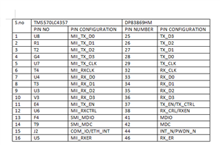

I am using TMS570lc4357 with dp82869 phy ic, and run loopback example, the phy is not responding,will you please what are the necessary registers I have to configure for tms570lc4357 emac and mdi eithdp83869 phy ic
  • Hi Guorav,
    I will help debug from the PHY-side. If possible, please share the PHY register dump while running this example so I can confirm PHY configuration and status.
    Tagging team that can help from the MCU-end.
    Thank you,
    Evan

    please fiind the above driver configuaration, and one more thing, while configuring with halcogen it os genrating drivers for dp83640 will it be possible if only change phy id and rev mask in that file
  • Hi Guorav,
    Yes, it is possible to change PHY ID and rev mask in driver - this isn't expected to affect driver functionality, only binding the driver on startup.
    Can you help me understand how DP83640 drivers are being used? Is the loopback example only using DP83869?
    Thank you,
    Evan
  • emac_loopback example runned and debugging with ozone segger, i got this
  • do the above images mean i am able to establish phy with tms570lc4357?

  • Hi Guorav,
    For the ping log, the signal chain is PC < - RJ45 - > TMS board, with 169.254.190.110 as the assigned IP address of the MCU board?
    In this case, I agree that the PHY is established with the TMS for valid link & communication.
    I cannot comment on the output log from the emac_loopback example.
    What functional tests are you looking to verify with the setup? Is ping and throughput measurement sufficient?
    Thank you,
    Evan
  • I assign default Mac address as given in example, not assign any ip automatically taken by pc
    I am going to lwip MQTT setup for the project,
    and in the loopback example I am not able to see pbuf_array, if not esablished please suggest the correct example of loopback and driver of dp83869 suitable with tms570lc4357.
  • as afunctional test loopback mode is sufficient
  • Hi Guorav,
    As I'm not familiar with this loopback example code, can we run through separate test to verify loopback functionality?
    What I have in mind is:
    - Enable reverse loopback on DP83869
    - Generate packets from Link Partner <-> DP83869
    - Verify same packets are received by link partner
    This requires manual register access to DP83869, as well as a link partner capable of generating and checking packets. If this works for you, I can share register scripts to run through this test.
    Thank you,
    Evan
  • ok how it can be done, I dont know about    reverse loopback
  • Hii evan, is there any other method to verify the phy has been established with emac
  • Hi Guorav,
    Reverse loopback is enabled with 0x16[5] = '1'.
    If you have packet checking functionality on the MCU, another method to verify is to have DP83869 link partner send frames over MDI, and verify these packets are received by the MCU.
    Thank you,
    Evan
  • Hi  evan I do not have setup for reverse loopback functionality, please just verify the above 83869 drivers and request for configuration steps with tms to establish connection, I wrote only those registers which are configured in halcogen generated emac code
    Thankyou
  • Hi Guorav,
    I understand. For the DP83869 driver, did you use a specific file as a reference to create this? The structure is different from what our PHY team has seen for Linux / RTOS drivers.
    Here is a reference for Linux:
    https://github.com/TexasInstruments/ti-ethernet-software/blob/main/linux_drivers/dp83869.c
    Can you verify if the PHY ID in dp83869_getid() is returning 0xA0F3 or 0xA0F1? This ID must be recognized for driver to bind.
    Thank you,
    Evan
  • Hi Gourav,
    I am closing this thread as you already created below new thread for this:
    (6) TMS570LC4357: tms570lc4357-dp83869 - Arm-based microcontrollers forum - Arm-based microcontrollers - TI E2E support forums
    So, please provide your comments in the new thread.
    Thanks & regards,
    Jagadish.
  • this is includes both dp83869 and tms570lc4357 thats i make 2 seprate threads,
  • Hi Guorav,
    We can keep this thread for PHY-level queries. Jagadish and Guorav please share any doubts from the PHY-level here while debugging on the separate thread for TMS.
    Thank you,
    Evan
