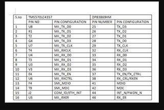

  • hii jagadish, I tried same, and run emac loopback example my code stuck in emac transmit function, please find the images.
    i have uploaded table of pin configuration with dp83869 and tms470, pin ball U8, R1, T2 and G4 AS MII_TX_D0-D3, E4 TXEN, T9 not found in data sheet as well as in halcogen, how do i configure it for transmission

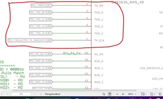

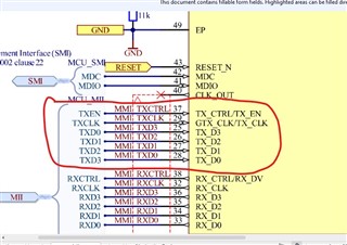

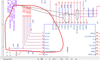

  • Hi Jagadish I have found diffrences in the schematic, do these  the reason, here in our schematic TXD[3:0] are connected invertly
  • Hi Gourav,
    I think this could create a problem:
    As there were two names in your schematic, i also confused in my verification for the first time, the red color names at PHY side looks correct but the blue color names looks wrong on the PHY side.
    However, i think the connections between PHY and controller made using blue names. So, the real connectivity between PHY and controller will look as below:
    As you can see TXD0 at controller finally connected to the TXD3 at PHY, similarly TXD1 at controller to the TXD2 at PHY, TXD2 at controller to the TXD1 at PHY and TXD3 at controller to the TXD0 at PHY.
    This will may not affect the MDIO communication between PHY and controller as this communication takes on other lines MDC and MDIO, that is the reason maybe we don't have any issues for PHY ID receiving and PHY link status etc. However, this might create issues for ethernet data communication, here the bits might be shuffle and the data might be received wrongly by other end device like router or PC.
    Thanks & regards,
    Jagadish.
  • How to rectify this,using pinmux settings, or any configuration in software
  • Hi Gourav,
    I think firmware wise we can't rectify this issue as it is related to hardware pin connectivity.
    I am thinking of two ways:
    1. I think we should somehow need to disconnect these pins connectivity between controller and PHY IC and should need to connect them correctly using external wires.
    Maybe we should need to identify these four tracks on PCB and need to cut them and need to make right connectivity using external wires. Maybe this is not an easy process.
    2. I hope this PCB is a prototype PCB, so maybe you need to design another PCB with right connectivity.
    I don't know any other possible ways.
    Thanks & regards,
    Jagadish.

    HL_phy_dp83640.hHii, Jagadish as we have discussed regarding wrong pin configuration, we have inverted pins, also, I try making changes in hdkif.c, now every time my code is stuck in hardware initialisation error, I'm both cases DHCP and static IP, what may be the possible reasons.
    I am able to read all register value correctly, advertise 1000bps disable,as per data shéet, linkstatus also correct value receiving but at the end it is showing hardware initialisation error
