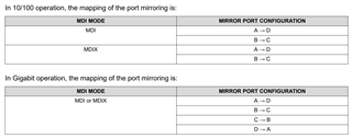

One question on LED_0 strap option. When I set it to mode 3, does that mean ports are mirrored internally or port mirror feature is enabled?
My hardware is able to connect to PC only in mode 3 but not in mode 1 (with no change in rest of the hardware/software). I have not swapped the ports in my PCB.
Bhagavath
  • Hi Bhagavath,
    Mirror mode remaps the PHY channel ports internally:
    In this case, it seems mirror mode is required as there is some port crossing occurring, either on the board traces / cable / RJ-45 connector.
    Thank you,
    Evan

    Thanks for sharing the registers. Register 0x11 = 0xBC3E indicates that the PHY detects reversed channel polarity on the channels due to wire crossing.
    Reviewing the schematic and magjack diagram again, I don't see any wire crossing. Can you please share the layout file so I can review if the symbol was potentially inverted or crossed in some way?
    Thank you,
    Evan

    Regarding mirror enable, you are correct. Ports A & D and ports B & C are swapped in the connector because of wrong pin assignment in the connector footprint. In the connector footprint, pins 1-6 are mirrored, similarly pins 7-12 are mirrored. Surprisingly & thankfully this error exactly matches with the ports mirror feature of DP83867.
    Glad we found the cause here, and thankful that the accidental pinmapping is acceptable for mirror mode.
