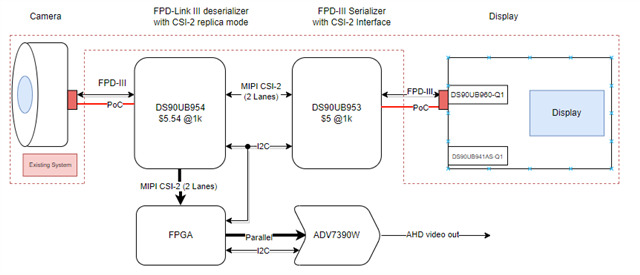

After asking a previous question about a proposed system, I now have it physically setup and require further assistance relating to the I2C passthrough.
I had the following response related to passing the I2C data between camera and display:
This line up should be compatible. If the camera is able to lock onto and function properly with the 960 in the original system, then the camera should be compatible with a 954 as well. If you have the original system available you may be able to determine which serializer is being used by the camera via the device's registers. There are ID registers that can be read to determine the device, for example see registers 0xF0 - 0xF5 on the 953.
I can see that the 960 is able to communicate and setup registers on the 953 (I can see the GPIO setup registers change value when the 960 is connected to it), but I assume that back channel setup data is intended for the camera? I do not know the address of the camera and I cannot access it's I2C lines as it is encapsulated. I have observed that the 960 is sending out I2C writes, over the back channel, to addresses 0x10, 0x08 and 0x50.
My 953 has address 0x18 and my 954 has address 0x34. What registers do I need to setup to get the I2C commands from the display to the camera?
I know I need to setup passthrough and update the IDs, but beyond that I'm a little unsure.

    Yes, you can access the image sensor using the pass throu mode. Let’s assume 960+953 is link A and 954+ Cam SER is link B and Imager is 0x20:
    SoC --> 960 (A) --> 953 (A) --> 954 (B) --> Cam SER (B) --> Imager.
    Program 960 (A):
    0x58[6]=1 for Pass-throu enabled
    0x5D: SlaveID[0] = 0x20
    0x65: SlaveAlias[0] = 0x20
    Program 954 (B):
    In this way you can access the Imager on the camera.

    I now have ACKed I2C commands going from the SoC to the Cam SER(B) and Imager. I also know that Cam SER(B) is another 953. So we have:
    SoC --> 960 (A) --> 953 (A) 0x19 --> 954 (B) 0x34  --> 953 (B) 0x21 --> Imager.
    Both Lock and Pass LEDs are ON, for both the 960 (A) and 954 (B). The problem I am having is that although the I2C commands for the imager are being passed through; the 953 (A) is being setup as if it was the camera serializer, which it isn't. I've tried adding in address 0x19 as a 953 (A) Alias ID (reg 0x41) and remapping it to 0x21 with TARGET_ID (reg 0x39), but this has no effect. I've also tried fixing the device ID register using Device ID Register (Address 0x00), but the 960 (A) is still loading new values into the 953 (A) over the back channel.
    So my question is, is there anyway to stop 953 (A) registers from being written to over the backchannel?
