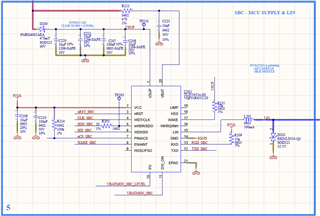

    Thanks for reaching out! Generally, BCI performance is a big factor of layout. From looking at your schematic, it appears that you have a good amount of filtering on the input supply, so it could be helpful to look for ways to ensure very strong grounding in your board layout. Try to make sure that the incoming AC energy passes the filtering components before it is able to reach the transceiver, and that you have a small decoupling capacitor placed near the input supply pin to the device itself.

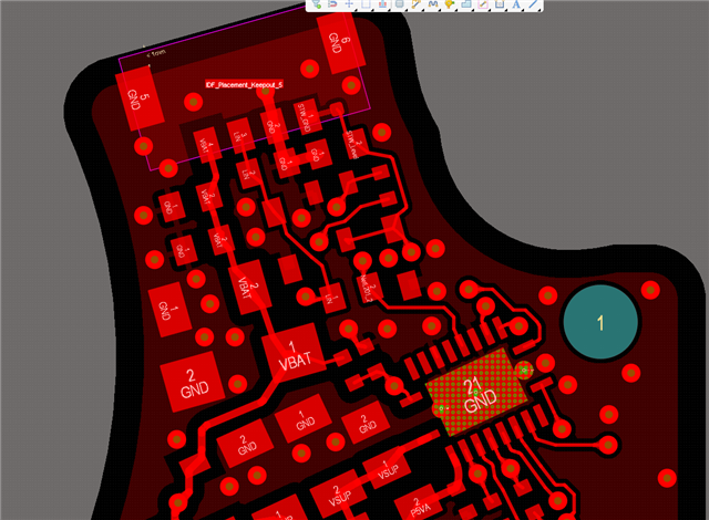

  • Hello Danny,
    This is the layout .We have a strong grounding for the filtering components.

  • Marian,
    My apologies for the delay - I had thought that I'd responded here but it looks like I dropped it on my end.
    Thanks for the additional layout information, it's helpful to see. From what it looks like, I believe you and your team have put together a strong schematic and layout. I do have one item that I'd like to check, and also some additional questions.

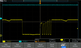

    For the two images you included, do I understand that the image on the left is without master connected, while the image on the right is with master connected? Based on what you described, it sounds like the responder/slave is adding an additional dominant pulse/bit, but just want to be sure. I see a sync field in both of the images.

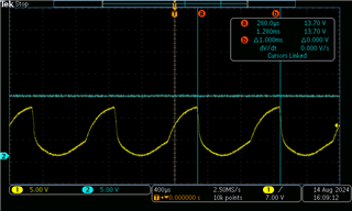

  • Hello Danny,
    Thank you for the answer.
    The image without master connected (measured at slave board) is the following:
    The other 2 images are with the master connected during the BCI test.

    You mention that you used a common-mode choke - by this, do you mean a ferrite bead L201?
    I noticed that the TXD pin does not have decoupling shown on the schematic. Is there a way for you to try and add some slight decoupling capacitance on this line in your lab to see whether the performance is changed? It would only need to be something small, perhaps a few picohms.
