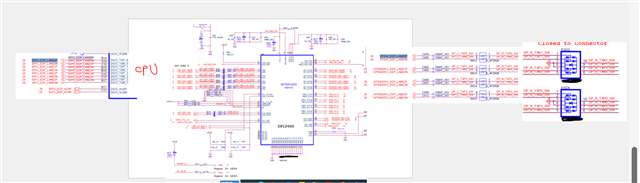

  • Please see the schematics. The EQ settings are default (0 dB).  I want to understand if the above eye mask overlapping can be occurred due to TI driver set at 0dB. if yes, does the eye diagram affects my display signal without any change in the output swing or register.

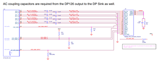

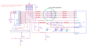

    What is the package of the resistor and capacitor on the main link outputs? They should be 0201. What's the value of the resistor on the main links? This should be no more that 0-3 Ohms.
    Also try removing the ESD and see if that impacts the eye.

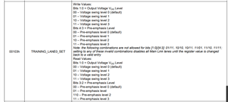

    Yes it seems that the signal needs some equalization. Try manually setting the EQ and see if that improves the eye height.

    In the future please use 0201 size passive components on the main link trace.

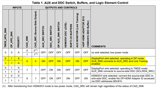

    The root cause is that the redriver is not properly configured. Are you able to send a pdf of the schematic? Its best to have this device snoop the aux.
    Have you implemented the proper pull ups and pulldowns on the aux lanes?
    Is the device implement as follows?
    Increase the EQ and measure the eye manually or have the device participate in link training and configure itself and capture the eye.

    Hello, please see the attached pdf schematics. There are 2 Dp ports (1 DP ports driven directly from CPU, 2nd DP port driven through TI redriver chip). Things to observe was the eye diagram and pre-emphasis level verification testing failed for TI redriver chip. please suggest your findings and observations and how this can be mitigated? Do we need to do any changes in the design or firmware? or there won't be any performance issues despite this eye diagram and pre-emphasis not passing compliance.

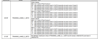

    The eye-diagram test is not low risk and there must be a passing eye to avoid future interoperability issues. This will require debug and potentially editing the firmware. There are a few ways to improve your eye diagram test. This test must be passed.
    1) improve EQ
    2) change output swing settings
    3) have the part participate in link training.
