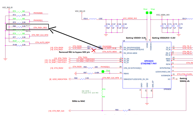

    • RXD1 = '0' we are getting. From HW we have added pullup but during bootup SOC itself making it down.
    • During boot we are getting some transactions on the MDIO line.
    • We are getting voltage across RBIAS resistor = 0V. But we are getting this 0V in master made as well. And master mode is working fine.
    • Please check below scopeshot of XI on phy side.
  • Hi Amol,
    Thank you for confirming the test results.
    If RXD1 strap is pulled down by SoC, driver binding and register access will fail as the device defaults into RMII master mode and expects 25M clock on XI.
    The PHY cannot operate unless compatible XI is provided, relative to RMII master (25M) or slave (50M) mode.
    Is it possible to power the PHY first before the SoC, to ensure RX_D1 is strapped high before SoC drives the pin low?
    Thank you,
    Evan

    We tried to make the RXD1 pin as '1' during boot up. We have probe the signal as well & getting '1' but after some time it is getting '0' because same pin is going to be used as RXD1 in ethernet communication. Upto what time we need to keep this pin High to make it as strapped ?
  • Hi Amol,
    The PHY needs around ~250ms to latch strap values after power rails have ramped.
    To confirm the strap is being set correctly:
    • Is 3.3V or 1.8V VDDIO being used?
    • What is the voltage seen at the pin on power-up (before MAC drives it low)?
    • After PHY power rails ramp, how much time passes before MAC drives pin low?
    Thank you,
    Evan
  • Hi Evan,
    1. we have used 3.3V as VDDIO.
    2. We are getting 3.3V at pin before MAC drive it low.
    3. After PHY power up rails for 40ms this is getting 3.3V before MAC drive it low.
    we will try to increase the delay 250ms as your suggestion and test it.

  • Hi Evan,
    We have bypass the SOC pin & monitor the strapping pin RXD1. We observed that phy itself making it low after 40mS. Can you please guide further ?
  • Hi Amol,
    I may be mistaken about the timing before PHY begins driving the output pin, but if SoC is not connected then this strap should be setting properly.
    In this case, are you able to access the PHY registers through MDC/MDIO?
    The key test plan is:
    1) Verify SoC is not driving the pin low on start-up so device straps into RMII slave mode properly.
    2) Read back PHY register dump to confirm PHY has the correct configuration for communication
    Thank you,
    Evan
  • Hi Evan,
    Please see below response over test plan
    1) We have isolated the path from SOC to this RXD1 pin & verified that SOC is not driving the pin low. The phy itself is making it low.
    2) We tried to access the PHY registers using MDC/MDIO but not getting the correct data. Every register which we tried to read it is getting 0x00.
    Can you please share your thoughts on below queries ?
    1) Is there any special command to read the phy registers using MDC/MDIO ? We have the commands but still to cross verify please share the command also.
    2) Did you checked the slave mode communication at your end ? Is this working ?

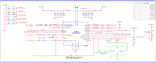

    3) Please refer to the below attached image. We have removed the R81 to isolate the SOC pin. In this case only pullup will be there on the RXD1 pin so it should be HIGH by default but it is getting HIGH only for 35~40ms & after that it is getting LOW.
    We are Using below attached driver. Please check this as well. If any upgrade or changes are required in it.

  • Hi Dhruvish, Amol,
    The same command used to read/write the registers for the working board (master mode) is expected to work.
    There are no changes to the driver required for debug here - register access should work independent of driver.
    Here are two additional checks to help isolate root cause:
    1) Please probe voltage on RX_D1 during startup. This should be >0.7xVDDIO for the strap to register high. The 40ms time before PHY drives the pin low is not a concern, the strap is being set during this time.
    2) What is the PHY address being used? It's possible MAC is driving PHY address strap pins (RX_D0, CRS_DV) , can you please iterate through other PHY addresses during register reads to confirm if this is the cause?
    Thank you,
    Evan
  • Hi Evan,
    We are not seeing RCSR bits and SOR1 mode setting in above driver code. As per the datasheet, few bits are responsible for the Master and Slave mode setting from this changes(RCSR bits and SOR1 mode).
    Below are the screenshots from datasheet:
    Can you please help to confirm the same if those changes are not required?
    Below is the driver code link from TI where we are seeing this changes available:
    github.com/.../dp83822.c
  • Hi Jenish,
    When the device is strapped into RMII slave mode, these bits will change to the appropriate values for slave mode on start-up. As 50M input clock in RMII slave mode is a prerequisite for register access, we need to validate the strap is being set.
    Driver changes are not required in this case, as RMII slave/master mode is not expected to change after strapping on start-up.
    Thank you,
    Evan
