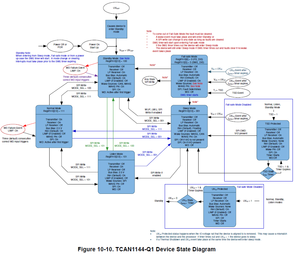

my customer sends the SPI command to change the TCAN1144 from Normal Mode to Standby Mode by updating MODE_SEL to Standby.
However, the current of the TCAN1144 is still higher than expected.
Only after 3 ~ 5 minutes the current of TCAN will drop to expected current.
Is this related to SWE timer?
Could you please give the hints “how to give the TCAN1144 go to standby with expected current immediately (without delay 3~5min) ?”.
Thank you for your support.
CK: Looking at the device state diagram I can find a note that entering Standby mode the SWE timer will start causing the delay?
Is there any way to avoid this??
BR
Carsten

  • Carsten,
    What is the expected current from the transceiver? The SWE timer causes the device to go into Sleep mode once fully elapsed, so this is why the current would drop once 3-5 minutes have passed.
    Eric Hackett

  • Carsten,
    The TCAN1144-Q1 is configured and controlled through SPI. SPI commands can be used to transition the device between different states, including Sleep mode. And no, there is no drawback to transitioning the device between states using SPI. The SWE timer is meant to be a feature that helps in case the device gets stuck in a fault state and doesn't continue to drain the power supply (typically battery) by staying in Normal or Standby states. And to be clear, the SWE timer, once elapsed, places the device in Sleep mode, not Standby mode.
    Eric Hackett

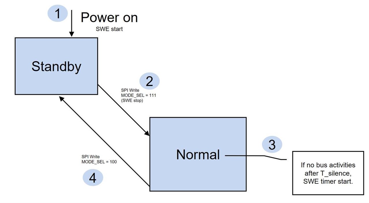

  • Team, customer is coming back with some more questions:
    Thank you for your feedback.
    Sorry for late response. I just back from vacation.
    Actually, our software only transitions from normal mode to standby mode (not sleep mode).
    Our sequences with below step:
    Step No.1: After power on, TCAN will go to the standby mode.
    Step No.2: Software changes the TCAN to Normal mode (by trigger command to the SPI -> MODE_CNTRL Register with MODE _SEL as 111b ).
    Step No.3: During normal mode, if the no message on CAN bus -> the SWE timer start after t_Silence. (Refer below capture from TCAN’s user manual)
    Step No.4: Software change the TCAN to Standby Mode.
    My question:
    • When SWE timer start in the Normal mode -> if Software trigger SPI command to transition from Normal to Standby Mode, is it stop/expired SWE timer here or it still running?
    • If we clear the CANSLNT interrupt flag and transition to Standby Mode, is the SWE timer stop/expired?
    • Will “Clear the CANSLNT” lead to any drawback/disadvantage ?
    Thank you for your great support.
  • Hi Carsten,
    1. The SWE timer will keep running in this case if tSILENCE (SWE_DIS=1) or CANSLNT (SWE_DIS=0) still persist
    2. Yes, it will be cleared if they configure SWE_DIS=0
    3. No, there's no disadvantage
    Sean
  • Sean,
    regarding item #2:
    "Cleared" mean that the SWE timer will stop and be skipped?
    BR
    Carsten
  • Hi Carsten,
    It means SWE timer will stop and be reset.
    Sean
