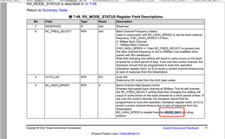

I use ds90ub947/948 find that sometimes ti948 have no ack on i2c transmission with back channel 20Mbps.
howerver, I set the back channel bps at 5Mbps ,then i2c works stable. as below, I modify the 948 register 0x23 to change the speed.
please, give me some advice !
