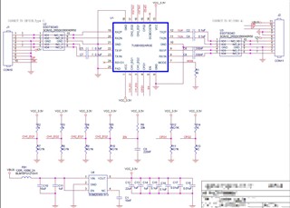

One of our project using TUSB1002A as USB3.0 redriver, and the USB/Typc-c interface needs to transmit a large amount of data (data output from network cameras). Can you help check the below schematic?

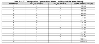

In addition, we also want to understand the impact of gain settings for CFG1 and CFG2 on high-speed signals. We only find the EQ configuration options for 1200mV Linearity 0dB DC Gain Setting on table 6-2.

    Is J2 the USB-A connector or is this a board to board connector? If it is a USB-A connector that is exposed to the customer, I recommend adding ESD diodes to the Superspeed SSTX/RX lines between the TUSB1002A and J2.
    Can you show a block diagram of the system? I'm not sure which side connects to the USB host/device and which side is routed to the USB connector.
    For a description on EQ, VoD, and DC gain, please see this E2E thread.

    Thanks a lot for your reply. The TUSB1002A is used in the middle of data lines as a signal relay.
    We will follow you suggestion to add ESD diodes to the Superspeed SSTX/RX lines between the TUSB1002A and J2.

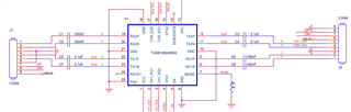

  • Sounds good. I would like to point out that you only need one set of 0.1uF capacitors on both SSTX and SSRX between the TUSB1002A and the USB host. I see you have 330nF on both RX lines connecting to the TUSB1002A:
    If there are no other capacitors between the 1002A and the USB host, I recommend changing the value of C1 and C3 to 0.1uF. This would be similar to the typical application section in the TUSB1002A datasheet:

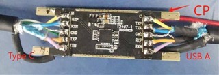

    Now we faced a new problem, that is, when we use this USB cable to connecting a camera , if we unplug J1 (device end), and the J2 connect to the computer normally, the USB device icon of the PC device manager will not disappear. And the device manager list will update only by reinserting J1 to the USB port.

    1. Does unplugging J2 remove the device from device manager?
    2. How is the type-C port implemented on J1? Typically you will need a CC controller and MUX to convert Type-C to Type-A.
    3. Does the 'scan for hardware changes' button remove the device correctly?
    Shane

    Do you have any suggestion for this problem? The schematic is as below:

    1. The RX detect parameters on the TUSB1002A are not adjustable. The SoC should enable terminations on the RX differential pins first. Once these terminations are present, our re-driver will go into active mode.
    we did not detect our RX terminal connection
    I'm not sure what "RX terminal connection" is referring to. The SoC should enable RX terminations by default if it is acting as a USB host and providing VBUS. Our re-driver will detect these terminations from the host and enable the corresponding receiver terminations on the re-driver.
    When the RX terminations are detected from both the USB host and device, the TUSB1002A will go into active mode.
    Do you see LFPS passing through our device when a connection is made? If so, RX detect is working correctly.

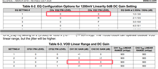

    Additionally, we suggest to modify the EQ CFG configuration and gradually increase it to see if there is a possibility of connection. When there is no Redriver, there is no problem. and when Redriver is added, there is a problem.
    This could be an EQ issue. I see in your schematic that you are maxing out the EQ settings which is typically not needed unless your channel is extremely lossy. Can you try lowering the EQ settings and see if it helps?
    Additionally make sure MODE is left floating like you described in your post.

    We adjusted the EQ from the highest to 0, but this problem still exists. But if the R1 resistor is connected, there will be no problem. While connecting the R1 will bring more serious USB recognition problems (Unplugging the USB, the device icon on the computer will always exist.)
