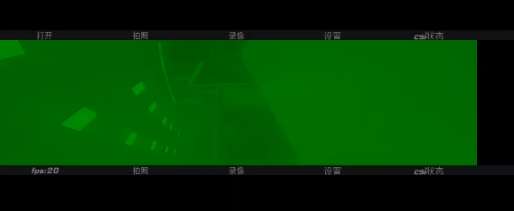

  • Hi Hamzeh,
    Thank you for the comments,I can show the camera, but there has green screen like this:
    Currently the resolution is 1024*600 and the data type is YUV422 10bit, do you have any idea what caused this ?
  • Hello Robin,
    Are you sure you are using YUV422 10-bit data type? because in the 960 reg 0x7C you are setting bits [7:6] to 10, which means you are not processing all 10-bits but only the upper 8-bits. Please change this to 00 and see if that changes your output picture.
    Also, on the 933 schematic, make sure to pull GPO2 to GND with a minimum 40kΩ resistor to ensure GPO2=LOW when PDB transitions from LOW to HIGH
    Finally, please refer to UB960 datasheet section "7.4.12 RAW Mode LV / FV Controls" and make sure follow the instructions and timing explained there.
  • Hi Hamzeh,
    I already changed reg 0x7C to 00 before the green screen output.
    I have read the section "7.4.12 RAW Mode LV / FV Controls" , but i cann't understand, can you give me a suggestion to set FV_MIN_TIME?
    and if the data type is YUV422 10BIT coming from UB933, Can UB962 change it to YUV422 8BIT?
