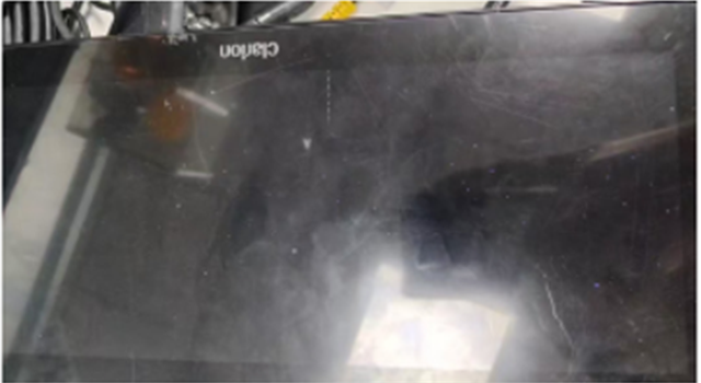

    No.1 We encountered a black screen after using the driver configuration parameters you provided, as shown below.

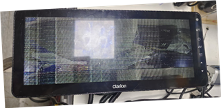

    No.3 The output video screen is shown in the following image.
    Could you please assist us? I would greatly appreciate your help.

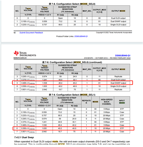

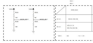

    Note that after a quick review of 941AS schematic, the MODE_SEL1 configuration is implemented as DSI inputs enabled / twisted pair / CLOCK from external osc.

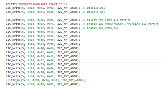

    1、Based on the response for this connection cable, we downloaded the driver configuration parameter file (941-948 example script). After using it, a driver black screen occurred (as shown below).
    DS90UB948-Q1: DS90UB948-Q1 /DS90UB941AS-Q1 Driver Code and Code Description Document support - Interface forum - Interface - TI E2E support forums

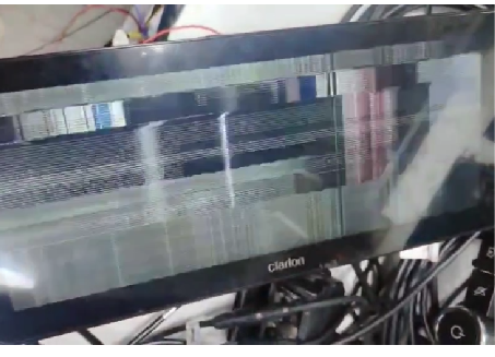

    2、The following link on the TI website describes a scenario that matches our current usage. We are currently using the IC with the configuration below. The output from the 941 is as follows:
    Test mode display: flickering black stripes appear.
    DS90UB941AS-Q1: UB941 output 1920x720 color and resolution abnormal - Interface forum - Interface - TI E2E support forums

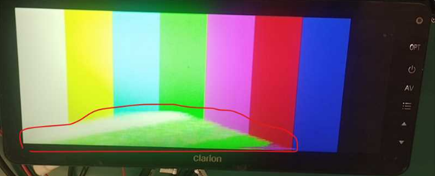

    The following shows the internal clock self-test mode of the 941. Below are the register values and display screen; please help take a look.
    0 DSI input, 941 register values and display screen, using an external clock, 27MHz.
    DSI input, 941 register values, and initialization code for 941 and 948

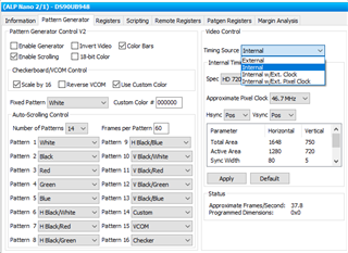

    Thank you for the information, but please provide reg dump including indirect reg dump to check DSI error flag since DSI error is detected. If possible, please share the reg dump with text, not screenshot.
    Could you also share the display timing? I would like to double check about the DSI clock frequency since you put the value as 0x1E that indicates around 300MHz I guess.
    Have you ever checked the PATGEN with 948 only to verify the target timing and no system-level display-side issues? Have you tried with internal timing source? I would recommend the following steps for video control/timing source to see which factor would be issued:
    1. Deserializer PATGEN
      1. Internal - Internal timing source / Internal PCLK
      2. Internal timing source / External PCLK
      3. External - External timing source / External PCLK
    2. Serializer PATGEN

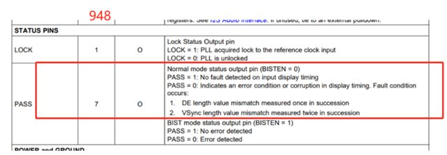

    Additional comment - One more thing during the 948 schematic review; 948 MODE_SEL0 is implemented pull-up 15k / pull-down 18k as below, but we don't have the configuration for MODE_SEL0. The reg 0x49 and typical voltage of 15k/18k with 3.3V are shown as MAP_SEL = H and Dual SWAP output. Please clarify if the configuration is correct.

    We could not confirm. As shown in the figure, we used the 948 to check PATGEN solely to verify the target timing, but an issue occurred on the display side.

    This is the resistor that 948 currently MODE_SEL [1:0] attached. The data has been grabbed out with text, please help confirm whether there is a possibility of instability in the 948 data?
    Since the PATGEN with 948 only is not working properly, we first need to verify the target timing and no system level on display side. What timing control did you select when checking PATGEN with 948 only? We can narrow down to what factor to issue, such as internal/external timing sources or internal/external PCLK.

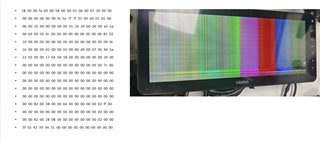

    There were some errors in the previous description. I update the latest status now. 948 PATGEN is normal, and  941 PATGEN use internal clock is also normal. 941 PATGEN use external clock have some issues (have stripes). We hope to receive guidance on resolving abnormal stripes.thanks !
    941 reg dump

    948 reg dump

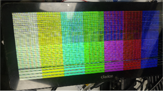

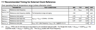

    The issue with external clock is indicated about discontinuous DSI clock and clock requirements as following the flow chart in app note. Please see section 4.1 in app note.
    Note that the external clock should be the same frequency as the PCLK. As per the DS90UB941AS datasheet, the external clock should be programmed to be the same frequency as the PCLK.
    Could you clarify again what the format/frequency of your DSI input to the 941AS is?
    • What video mode is the SoC operating in (burst mode, non-burst mode with sync pulses, or non-burst mode with sync events)?
    • What clock mode is the SoC DSI clock set (continuous mode or non-continuous mode)?
    • What is the DSI rate and what is the PCLK (85 MHz or 95 MHz)?
    Josh
    we use video mode is sync pulses   .RGB888 ;
     DSI clock is continuous mode;
    DSI rate is 1984*792*60*24/4/2=282.8M
    PCLK is 1984*792*60=94.3M
    The data we obtained at the 948 output is different from what we set at SOC:
    getfor948
    fm_value:32914
    lvds_clk_in:32914
    Port B lvds clock:
    fm_value:32914
    lvds_clk_in:32914
    sync_polarity = F
    LT9211_VideoCheck
    hfp: 2172
    hs: 1
    hbp: 14
    hact: 1920
    htotal:9
    vfp: 89
    vs: 7
    vbp: 24
    vact: 720
    vtotal: 1864
    SOC set
    m_wHactive = 1920;
    m_wHpw = 8;
    m_wHbp = 12;
    m_wHfp = 44;
    m_wVactive = 720;
    m_wVpw = 7;
    m_wVbp = 8;
    m_wVfp = 57;
    m_wFps = 60;
    HTotal = 1984;
    VTotal = 792;
    Is this a problem with setting up registers for 941 or 948?or SOC output timing is error ?

    Based on the PCLK (94.3MHz) and DSI clock frequency (282.8MGbps), the incorrect TSKIP_CNT value was programmed as 0x1E.
    • f_DSI = 0.2828 GHz
    • TSKIP_CNT = Round (65*f_DSI-5) = 13 which means you need to program 0x1A to indirect register 0x05, not 0x1E.
    Josh
  • Hi Josh
    0x42 set 0x1A

    We measured that the value of 948 is PASS=0:, indicating that an error has occurred now. Which part caused this error?
    The datasheet you refer to is an old version. The new datasheet gives the correct description for PASS on 948. Note that it is not used during normal mode, so PASS = 0 is the expected behavior.

    I have reviewed the schematic and have some feedback. Since you selected External Reference Clock Mode on MODE_SEL1 (#4), you need to match the frequency with the desired DSI clock, not 27MHz for the external clock as you mentioned above, and it is not clarified the OSC spec in the schematic. Please see the requirements in the app note.
    Josh

      our DSI clock is 0.2828Ghz ,Pclk is 94.3M .so Should the external clock be set to 94.3MHz ?
    Best
  • Hi Masami,
    External Reference Clock Mode utilizes an external clock on the REFCLK0 or REFCLK1, and it is recommended that this be matched to the DSI PCLK. This also follows the equation described below.
    I recommend seeing the app note I shared above. It will guide the consideration of the DSI source configuration and the implementation of a solution with 941AS.
    Josh

    We have chosen a suitable external crystal oscillator、BRIDGE_CFG2[1:0] Reg is set External Reference Clock Mode. But now it's consistent with choosing
    DSI Reference Clock Mode。If we choose DSI Reference Clock Mode。 Except for the indirect register 0x05 and set  dsi is  DSI_CONTINUOUS_CLOCK ,Do we need to configure other registers for clk?

    Have you checked if it is enabled PATGEN with internal timing and an external clock from 941AS?

  • Hi, Josh Baik
       We have tested all the registers mentioned above, but the stripes still exist。Is it possible that this is a hardware issue?
    Best
    I don't think the register configuration is a priority at this point. Before further investigation about the hardware issue, please confirm if you followed the bring-up flow chart since the above question has not been answered.
    Josh
  • hi Josh
     I use PATGEN with internal timing and an external clock from 941AS,Also has stripes。
