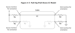

  • Hi Alder,
    In a standard type-C cable, only one CC line will connect through from plug to plug. The other CC line will be left NC or terminated to Ra within the cable depending on whether it is an active or passive cable. Here is a diagram from the USB-C spec that illustrates this:
    The Source TUSB321 will monitor both CC lines to look for the Rd pulldown. Similarly, the Sink TUSB321 will look for Rp on one of the CC lines. Depending on which orientation the cable is in, one CC line on the source side will connect to a CC line on the sink side. Once the appropriate pullup/down is detected, the CC controller knows which orientation the Type-C cable is in.
    Shane

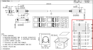

  • Thank you Shane,
    I see there is a cable that have both CC1 and CC2, for those cable, the detection will not working, right?
  • Hi Alder,
    The USB spec defines one configuration channel in every USB-C cable. The other CC line can optionally be used as VCONN, but should not connect through:
    If both CC lines are connected through the cable, its likely that the orientation detection will fail.
    Shane
