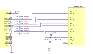

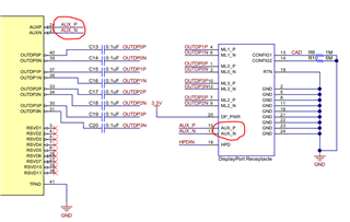

Hi all,
When connecting to the DisplayPort Sink, The AUX pin has AC coupling and pull-up and pulldown.
However, when connecting to the DisplayPort Receptacle, it is not connected with AC coupling but directly connected.
Is this a typo?
