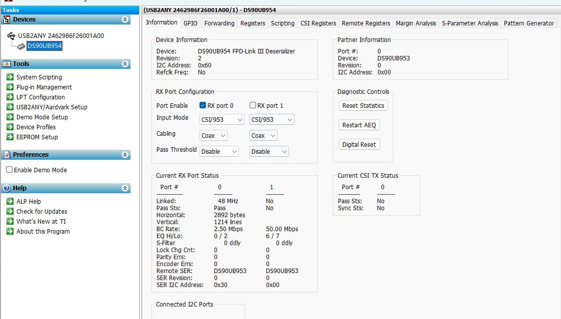

高通845芯片的linux系统,摄像头驱动为软件i2c操作的,不用954和953时可出图像。
现在添加了954和953连接摄像头后,i2c配置完954,953后可访问摄像头I2C,但是运行摄像头驱动软件后,显示SOF freeze。

这是954和953的配置,摄像头驱动软件与不添加954、953之前一样。
报错信息:
[ 1012.459062] CAM_INFO: CAM-SENSOR: cam_sensor_match_id: 666 TIAN read id: 0x5803 expected id 0x5803:
[ 1012.459078] CAM_INFO: CAM-SENSOR: cam_sensor_driver_cmd: 823 Probe success,slot:0,slave_addr:0x6c,sensor_id:0x5803
[ 1012.459325] CAM_INFO: CAM-SENSOR: cam_sensor_driver_cmd: 896 CAM_ACQUIRE_DEV Success, sensor_id:0x5803,sensor_slave_addr:0x6c
[ 1017.698105] CAM_ERR: CAM-CRM: __cam_req_mgr_process_sof_freeze: 1168 SOF freeze for session 11403776 link 0x330104
[ 1017.698151] CAM_INFO: CAM-ISP: cam_ife_csid_sof_irq_debug: 2683 SOF freeze: CSID SOF irq enabled
  • 摄像头为 OX03C10

  • Resolution is 1928x1208, and the image below shows the status of ALP, but it reports "SOF Freeze." I would like to know if it is due to an incorrect setting of a register on the 954 or 953.
  • Hi Lijun,
    What mode of the 953 is being used here? In the screenshot, the back channel rate is showing as 2.5Mbps which is used for DVP mode.
    Would you be able to provide a complete register dump of the UB954 main page registers to clarify the system set up here? This can be collected by going to the registers tab and selecting display registers on the right side.
    Zoe

    thank you
  • Hi Lijun,
    From a configuration aspect, I don't see any errors here and CSI pass is asserted based on the register dump that was provided. Does the SOF freeze reported mean there is no active data being input to the SoC?
    In the register dump that was provided, there are CSI errors and CRC errors being reported here. These errors may occur during initialization of the devices and are recommended to be cleared once initialization is completed.
    I recommend confirming the SoC is configured to expect 4 lane CSI-2 data at 800Mbps in continuous clock mode. No calibration is enabled on the deserializer side.
    Zoe
