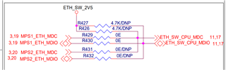

  • Hi Litesh,
    I noticed that the MDIO pull-up resistor is DNP on the schematic, This is probably why there is no register access for this device at the moment, and why the drivers are not loading properly. Adding this PU resistor should help with driver detection and register access

  • Hi Vivaan
    To address this, I made the following changes:
    1. Removed R429: This resistor, which was marked as DNP (Do Not Place) and 0 ohms, was causing an open circuit on the MDIO line.
    2. Shorted R431 and R432: These were shorted to ensure proper routing and signal integrity for the MDIO and MDC lines.
    3. Used Jumper Wires: I have temporarily routed the MDIO and MDC lines to the Ethernet pins using jumper wires to bypass potential PCB layout issues.
    Despite these changes, I am still unable to detect the PHY using MDIO commands. The PHY does not respond to register reads, and the driver is not loading correctly.

  • Hi Litesh,
    I am a little confused by this. The schematic shows that the resistor is not DNP, but placed. Did you remove this resistor? If so, this would disconnect the MDIO line to any devices connected to MPS1_ETH net.
    This enables devices connected to MPS2_ETH to the CPU.
    Even in this configuration, a pull up resistor on MDIO is still a requirement that has not been met. Resistor R427 must also be placed for meeting this requirement and enabling MDIO communication.
    I would also verify that the PHY address of the PHY you are trying to connect to over MDIO is correct. T
