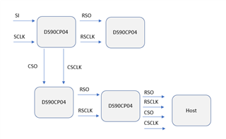

Hi team,
My customer had a request.
I need to use this switch as an LVDS repeater, but I have  4 of this part to handle 12 LVDS repeaters (I do need 2.5V VDD)  and
here,  I read that we can daisy chain for program/configuration  via clock and SI/Lel1
The issue is that there no samples how to daisy chain and the website doesn’t have any application besides the attach PDF
So  I am not sure how to daisy chain  the RS0/CSO, RSCLK/CSLK   to save pins  I/O  since I have 4 parts  to make 12 LVDS
Can you provide guidance on what pins need to be connected where to properly daisy chain?
