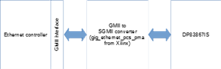

    In the FPGA design I have an Gigabit Ethernet controler IP which can be configured to send data to the PHY. The Ethernet controller reads the descriptors that are set up by the software and sends out data using a DMA engine and updates the descriptor after sending.When I set the phy in 'NOT loopback' mode, and run the test I can see that the transmission happens correctly, the ethernet controller updates my descriptors after sending the data out.
    When I configure the PHY in loopback mode, I could see that the link up status is '1' from phy. However I see that none of my descriptors are updated which indicates that the transmission is not happening. And there is a timeout in my test and I hit that. This points to data not being transmitted.
    Then I tried the PRBS test as described in the PHY user manual, with PHY set in loopback, to see if that works.
    Please see my system set up below.
    Would it be something related to the clock that comes into the SGMII interface from the PHY, when the phy is in loopback? Is there a way to verify that clock is running properly?
    Krishna
  • Hi Krishna,
    Thank you for the detailed explanation of your setup.
    Would it be possible for you to verify that the packets are not being sent by probing the TX line going into the PHY?
    It looks like the packets are being recognized by the PHY since we can see them in the PRBS counter registers while in loopback.
    It may be software behavior that is the cause of the descriptors not being updated. Putting the PHY in loopback disconnects the MDI line from the datapath. Perhaps the trigger for updating the descriptors is being missed when enabling loopback mode.
    Vivaan
