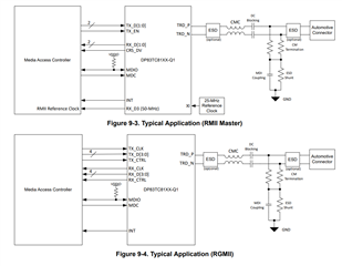

Looking at our DP83TC813 recommended settings it seems like if you are using any MAC interface it is necessary to connect a reference clock.
However considering the RGMII application:
It seems like there is no clock added.
Is this some an issue in our datasheet or is there really no need for adding an external clock when running on RGMII ?
If so, how is the Clock generated ?
