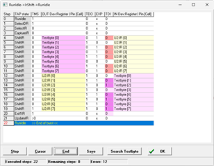

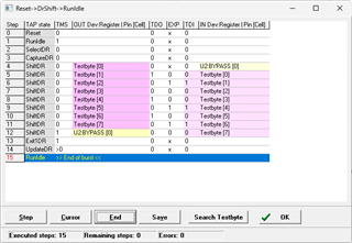

on behalf of my customer, I'm asking to get the BSDL-File for DP83869HMRGZT.
the BDSL files mentioned in these threads (https://e2e.ti.com/support/interface-group/interface/f/interface-forum/1091022/dp83869hm-dp83869hm-48-pin-bsdl-file und https://e2e.ti.com/support/interface-group/interface/f/interface-forum/901288/dp83869hm-bsdl-file) seems to have an issue.
It looks like the length of the instruction registers is not correct, 9 instead of 8bits. Also the Capture Values seems to be incorrect.
