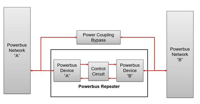

    So with that in mind the best way to move forward hitting that distance is with a Power bus repeater  - we did some preliminary testing on the concept last year - and I have attached our findings to this thread. We did use the highest modulation frequency for testing as higher speeds were our concern - I don't see too much concern at 750kHz or 500kHz using something similar - but the timing elements will need to be modified for your specific system.
    As a sneak peak - this is basically what you are looking at for a repeater - two THVD8000's and a control circuit in-between them to control the logic of the devices.
    Essentially the repeater control circuit is two circuits - one to control the mode of the THVD8000 and one to delay the data by one bit.
    Since you are not using Power Line Communication features of this device you can ignore the power coupling bypass.
    What happens is that both sides of the repeater are in RX mode until they receive a data frame at which time the opposite side of the repeater is changed to TX mode and then the frame is transmitted to the rest of the bus. The data delay is there so that bits are not dropped during the mode transition.
    This solution does have down sides:
    1. It adds some propagation delay to system - so more repeaters more propagation delay is added - which should be taken into account for any control system. For example if one device in sub-system A and one device in sub-system B turn transmit at the same time - you may not see a collision right away and it could take longer than standard before the collision is seen.
    2. You need to use a Frame based communication protocol - something like UART as the timing elements are based off the frame length - it doesn't have to be UART - but every transmission packet needs to be the same length and duration to properly size repeater - you could use an MCU instead of the logic circuit to increase flexibility - but it will also increase complexity
    3. It isn't as simple as a straight forward single bus - but at the speed and distance you are looking at it may be necessary.
