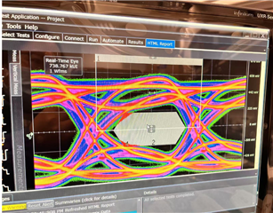

Below are customer's eye pattern test results, which work well with refresh 30 but failed with refresh 60. Do you have any insights on how to optimize it?
refresh 30:
refresh 60:

  1. Could you please help to give some adjustment suggestion to help customer complete the eye pattern test? such as, register modification... I have asked customer try to set to adaptive EQ mode and will post the results to you later.
  2. It's found that there is a drop on the waveform. Could you please also help to check the reason and how to fix it?

    Can you please share the actual compliance report and the full TMDS181 I2C register dump between the refresh 30 and refresh 60?

  • Rannie
    For 4k@60Hz, 0x0B -> 0x1B, this will set TX termination to 75 to 150ohm, and write TMDS_CLK_RATIO_STATUS to a 1.
    For 4k@30Hz, 0x0B -> 0x08, this will set TX termination to 150-300ohm, and write TMDS_CLK_RATIO_STATUS to a 0.
    For 720x480@60Hz, 0x0B -> 0x00, this will set TX termination to open termination, and write TMDS_CLK_RATIO_STATUS to a 0.
    On the TMDS_CLK_RATIO_STATUS bit and TX termination, they have to set the termination to 75-150ohm and TMDS_CLK_RATIO_STATUS to a 1 per the HDMI2.0 spec. If they set the TMDS_CLK_RATIO_STATUS bit to a 0, then the TMDS CLOCK output will be divide by 4 instead divide by 1, so the clock frequency will be wrong and they will have functional issue.
    Unfortunately we do not have a template code or driver for Linux since these are just I2C writes. They can also switch to pin strap mode and let TMDS181 automatically configures itself base on the DDC snooping and line data rate.
    Since each design is different, they will have to tune VSADJ and the register configuration to find a good value that can meet both the VSWING and VL requirement.
