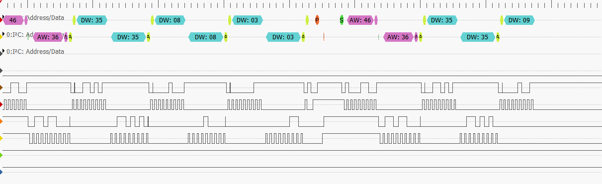

We are using the TDA4->UB962->UB935->OVX3F for our video pipline.
and currently we found a issue which happens in a small probability event.

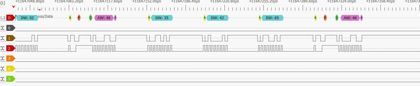

some of the I2C wave lost when we are trying to write some register:
and we connect all I2c between the TDA4 and camera
 for our system we use TDA4->UB963->UB935->x3fcamrea
and I measures all I2C in the system which is TDA4 I2c with UB962 and UB935 i2c with x3fcamera as follows
channel 1 2 is for the TDA4 side
channel 3 4,5 6, 7 8, 9 10 for the x3f camera side

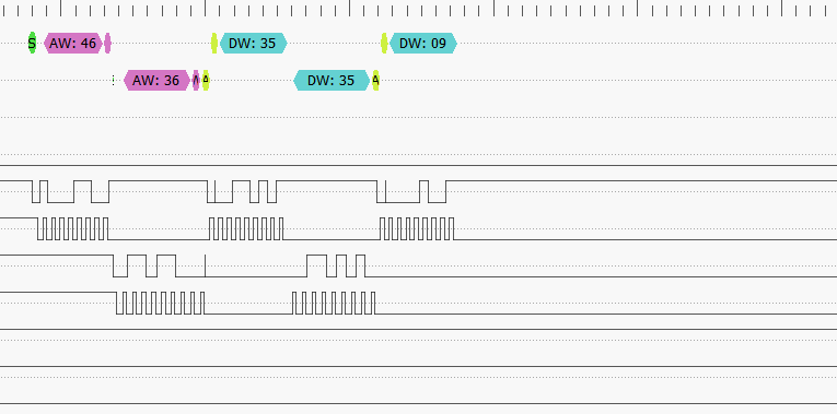

and in the timeline 10.75S here is a no ACK issue here
and if I zoom in the waves

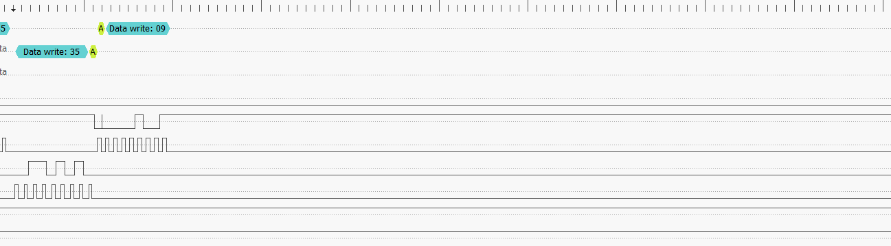

it trying to write some register to camera,
but when address 0x36 and the first reg data 0x35 was write to the camera
the next data 0x09 have not send by the UB935
it seems the 0x09 data was lost in the data line.that is very strange here.
could you pls help us why the data lost here.

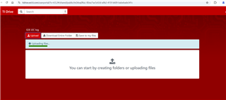

  • Hello Zoe,
    I try to upload the I2C capture but the upload failed it seems the source file was too big to upload,do you have the email or other methods to share the i2c capture file
  • Hi Yixiao,
    Can you try uploading here?
    https://tidrive.ext.ti.com/u/txG4oq0RuL-lEbix/1ac5c63d-a9b2-415f-b609-babebade341c?l
    Password: YXKw9Q3@
    Zoe
  • hello Zoe,
    it was already uploaded and you can open the file by using this tools
  • Hi Yixiao,

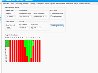

    for the MAP and BIST do we need the EVM board for caputure the data,can we use our ECU to do that?

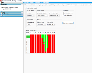

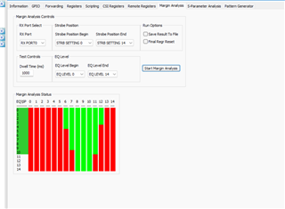

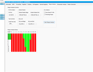

  • Hi Yixiao,
    An EVM is not required to run MAP or BIST. In order to use these tests on Analog LaunchPAD software, I2C communication via a USB2ANY or Aardvark is required. Attached is the example scripts for MAP and BIST for I2C communication:

  • Hello Zoe,
    here is the MAP result,it seems the port3 have the issue,and what the data lost was in port 3
  • Hi Yixiao,
    By default the device will start AEQ at an EQ level of 2. Would you be able to test lowering the AEQ floor for port 3 so that EQ levels 0 and 1 are included in this search and see if this improves results?
    This can be done via the following in the initialization script:
    1. Select RX port 3 0x4C=0x38
    2. Disable SET_AEQ_FLOOR 0x92=0x90
    3. Restart AEQ 0x92=0x98
    Zoe
  • Hello Zoe,
    But the port 3 already does not recommend,should we check the hardware design for that?
  • Hi Yixiao,
    This is correct, port 3 is not meeting the recommended passing criteria for the Margin Analysis Program. We would need to take a look at the hardware design in order to improve the margin here.
    The scripting changes were recommended from a debugging perspective as it provides more passing states in AEQ to see if a lower EQ setting may help performance here.
    Some examples for what may be impacting the margin analysis results are listed below:
    1. Power over Coax noise
    2. Insertion loss and return loss characteristics
      1. Cable type and length
      2. PCB board layout
    3. Hardware connections
    Would you be able to provide the schematic and layout for review with this in mind?

  • Hello Zoe,
    our hardware team actully already notice that,and they designed another layout for the new ECU,yesterday I get the new ECU and I use new ECU to get map
    here is the result
