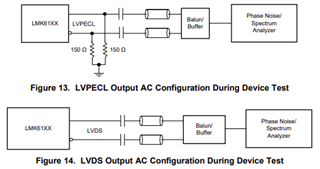

    Meanwhile the samples of LMK61E0-156M25SIAT are with us. Unfortunately initial testing with these showed same behaviour.
    Can somebody please sketch the proper connection of LMK61E0-156M25SIAT to the TLK10232 refclock interface (incl. termination resistor values etc.)?
    This should help to exclude any mistakes on our side.
    Thank you.
    BR
    Joerg
  • Hi Joerg,
    TLK10232 expects LVDS or LVPECL reference clock, so I believe either of the following designs can be used.
    Lucas
  • Thanks, Lucas.
    Just for a final confirmation: There is no need for a DC termination at the Refclk inputs of TLK10232 when driven by LVPECL? Or is there internal termination? The pin list mentiones DVDD as reference but Refclk swing is up to 2000mVpp, so I wonder how the internal circuit looks like.
    Maybe you can find our more about this...
    BR
    Joerg
  • Hi Joerg,
    Judging from LMK61xx datasheet diagrams and TLK10232EVM schematics, I believe termination should be connected as shown in Figure 13 for LVPECL.
    Lucas
