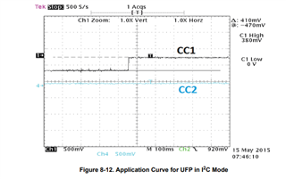

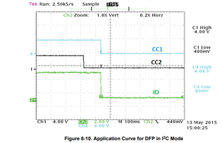

    If you could take some waveform measurements of the CC pins to see if this negotiation is taking place, or if it is similar to what we have in our datasheet, that would be good to check as well.

    Where are you measuring the CC pin voltages? At the CC controller, or the UFP device/source of the CC pins? Would it be possible to monitor the waveforms of the CC pins to see if there is any negotiation or just a flat value? Is there no way to control VBUS?
