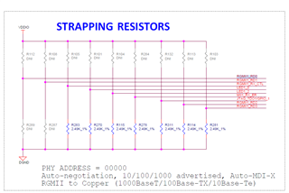

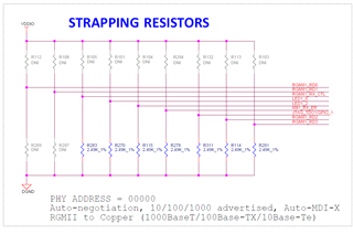

  1. Strap resistor setting for PHY address:
            We have connected same way as AM2634 PROC A schematic. as shown below. Please verify.

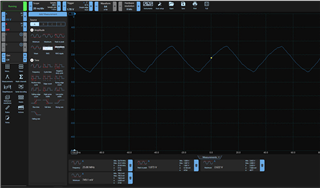

2. We have mesured RBIAS voltage:  300mv

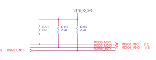

7. MDIO and MDC setting as below

    2. The DC voltage across the RBIAS resistor should be 1V. How are you measuring the 300mV at RBIAS? Can you power down the board and verify the RBIAS resistor value is 11k +/- 1%?

    2. I have powered up and checked RBIAS resistor value is 11K but voltage is very less than 1V. I have measured it across RBIAS by using TP2 as shown above.

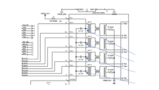

    Also looking at the schematic, I noticed that you are using center tap shorted magnetic. With the center taps shorted, we have seen link instability issues. You need to use a magnetic, such as HX5008FNL, to configure the center taps such that they are separately decoupled to GND as shown in the datasheet. Please also see this E2E FAQ for the magnetic selection, https://e2e.ti.com/support/interface-group/interface/f/interface-forum/1161575/faq-dp83867e-how-do-i-choose-magnetics-for-my-industrial-phy

    Did you also get a chance to replace the center tap shorted transformer?

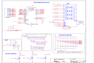

    I have not understood about magnetics of RJ45, Can you please explain more with diagram (if any)? How can I change magnetics? I have used same part no of RJ45 as mentioned in AM2634 proc card schematic page no 12 as below.
  • Ajit
    I am referring to the magnetic being used in the design which the center tap are being shorted together as shown below.
    We recommend to use a magnetic, such as HX5008FNL, to configure the center taps such that they are separately decoupled to GND.

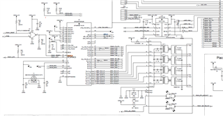

    However, when I checked schematic of  TMDSCNCD263 (Control Card of AM2634) from TI. I found that it has used  LPJG16314A4NL as shown on page no. 12.
    Please review it and let me know if any compatible part number of RJ45 that I can use for DP83869HM

    You can use Wurth Elektronik 7499111000A RJ45 Magjack Connector. This component has been used on the DP83867 EVM in the past so we have a history of validating our parts with it.

    At present, I am able to get RBIAS of 1V and clock out on pin 40 is also good. So, I think DP83869HM is responding okay.

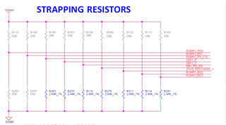

    I am confused with Strap resistor setting for below mode.
    PHY ADDRESS = 00000
    Auto-negotiation, 10/100/1000 advertised, Auto-MDI-X
    RGMII to Copper (1000BaseT/100Base-TX/10Base-Te)
    1. Schematic of  TMDSCNCD263 (Control Card of AM2634) shows below setting:
    2. DP8386X-ASPEED-EVM schematic shows below setting:
    Why so different?
    My board current strap resistor setting is like below.
  • Hi Ajit
    The strap setting between the TMDSCNCD263 and the DP8386X-ASPEED-EVM is functionally the same. The DP83869HM uses many of the functional pins as strap options to place the device into specific modes of operation. The values of these pins are sampled at power up or hard reset. As you can see from below, these pins have pulldown enabled during reset, so the pin strap will register as "0" in either case of DNP or external pulldown.

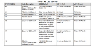

    There are the LED functions in RGMII to Cooper mode:
    If none of these LEDs are blinking, then I suspect the link is failing. Have you been able to validate the register access to confirm the link is up?
