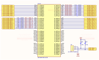

  • Attached is the schematic for DS160PT801 Lane. The EEPROM is using AT24C16C-SSHM-B.

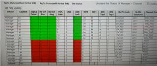

    I have confirmed that it is currently connected to SigCon Architect 3.1.
    Thank you.
  • I used the DS160PT801_4x4.hex file you provided for EEPROM.
  • Also, looking at the schematic, A_PER(left) is EP and A_PET(right) is RC.
    The datasheet says RC is connected to A_PER and EP is connected to A_PET, but my DS160PT801 board is connected the other way around.
    I'm currently testing my DS160PT801 board by connecting it between the motherboard and the NIC card.
    If I connect the motherboard and the NIC card without the DS160PT801 board, it connects to Gen2,
    but if I mount the DS160PT801 board on the motherboard and connect the NIC card, it connects to Gen1.
    Is the problem that A_PER and A_PET are reversed above, or is it because of the Lane in the configuration guide that I asked about at the beginning?
    I've attached a picture of SigCon Architect for additional reference.
    Thank you.
