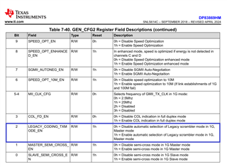

    I found that the newer DP83869HM has the function to disable the automatic selection of legacy scrambler mode, which is LEGACY_CODING_TXMODE_EN register. So, please confirm if DP83867IS has the same function as hidden register and consider answering my questions a. to g. above again.

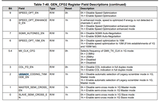

  • Hi Kato-san,
    Thank you for the information. I'm looking into legacy mode internally, so in the meantime lets try a few things that may help:
    1. Try setting register offset 0x14h bit 2 to '0'. I realize this is in the DP83869 datasheet, however sometimes these parts share registers that aren't always documented. I'd like to see whether this stops legacy mode from being enabled on the PHY:

  • Hi Kato-san,
    1. Yes, the same register exists for the DP83867. Please set this to '0' to disable the automatic entry of legacy mode when the DP83867 is in master mode.
    For more context on this mode:
    - Legacy scrambler mode changes the scrambler settings and will prevent communication between the DP83867 and standard link partners.
    - It was designed to support a few older ethernet PHYs that did not conform to the standard link up negotiation procedure.
    - The DP83867 will automatically fall back to this mode if it struggles to maintain a link in master mode.

    Additionally, the customer are testing by setting 0x50 bit 1 to '0'. We'll get the results tomorrow.
    The register you should set is 0x14h bit 2, not 0x50 bit 1. The 0x50 bit 1 register is only relevant when the DP83867 is in slave mode. In master mode, this will likely not have any effect.

  • Hi Shane-san,
    The symptom wasn't replicated if setting 0x14 bit 2 to '0'. This seems like a workaround, but we haven't been able to figure out the root cause. The customer will test trying to interfacing with STB using DP83867ERGZ-S-EVM. If there is anything else we should try, any advice would be very helpful.

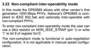

    For legacy scrambler mode, I found "3.22 Non-compliant inter-operability mode" on page 48 of DP83865 data sheet. I think it's probably the same function. So, if you could tell me the details, I would be very grateful.
    Yes I believe this is the same function as legacy mode. It is designed to support a link with older Broadcom PHYs that did not use the standard link up procedure:
