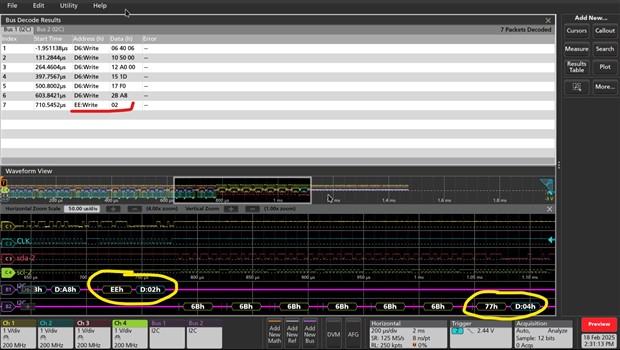

Issue to switch channels one by one using TCA9548A with address 0x77 connected with 4 other I2C devices (BQ25756).
1st time channel-1 selected as 0x01 data is properly write read from BQ-1 device. But when channel-2 selected 0x02, data was not properly read write and so on.
Also, when any BQ device is not connected on a particular channel, the TCA9548A communicates with channels and responds with ACK.
Instead, TCA9548A should respond NACK in that condition.
