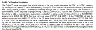

We are planning to go Malaysia for compliance testing on 27th Feb 2024.As per mentioned in datasheet, In Full Adaptive Equalization mode, TUSB1104 will automatically determine what it believes is the best equalization setting. In Full AEQ mode, the TUSB1104 will attempt to determine the best settings regardless if the channel is short, long, or somewhere in between. We are planning to use this mode.
So please guide us how to use this mode and how it works. Also please share application guide or procedure for using of Full AEQ mode.

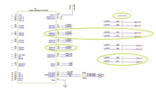

    In the schematic I see that the data path is from the FMC connector to the TUSB1104 and then to the USBC cable.

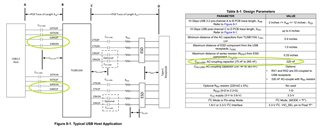

    1) values of C70, C72,C69,C71 should be 330nF not 220nF
    2) (optional) replace R46,R47,R44,R45 with 330nF capacitor
  • Hi Vishesh,
    Thanks for update. We have place 220nF capacitor as mentioned in datasheet. Please find attached image for more reference. Please share concern of 220nF capacitors if any. So we can change and check the results.

    This is how AEQ works:

    The reason I recommend this is because I do not know if there is any additional AC coupling on the USB host side. Capacitors in series will reduce the total capacitance of the bus. For example is the SSTX has an existing 100nF which is standard in a TX implementation. An additional 220nF will reduce the capacitance to outside of the USB spec. A 100nF with the 330nF will not. This is mostly as a precaution as I do not know what the signal path looks like past the connector.
    In Full AEQ with Linear Redriver Mode(In I2C mode),Can we get auto tune value of EQ if we run attached program? We got different value at every power reset. What was reason behind that?
    You cannot chnage the value of AEQ determined. You will need to go into fixed EQ mode to set this. AEQ only applies to the CRX1 and CRX2 lines. What is the USB-C cable being plugged into?
    You can limit the highest allowed EQ that AEQ can select using the following pin:

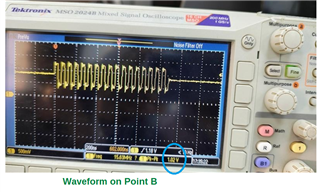

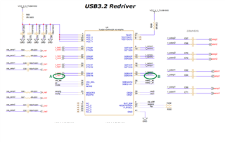

  •  Waveform on Point AWaveform on Point B
    Dear Vishesh,
    We have checked above waveform in LFPS mode.Peak to peak voltage on Point A(On Rx-Between Type C connector and Re driver)  is 660mV and Peak to peak voltage on Point B(On Rx-Between Re driver and FMC connector)  is 1.2V.Our setting for USB Connector Facing Port Receiver (CRX1 and CRX2 pins) is 0 for CEQ0 PIN Level and 0 CEQ1 PIN Level(mean -0.4dB EQ Gain).For -0.4dB gain how much Peak to peak voltage will come? As per our understanding  waveform says that the setting is around 3.5dB.So please share your suggestion for this.
  • What different EQ values did you get here when you reset the board?
  • 1.2V signaling coming into the TUSB1104 may oversaturate the RX pins. This may push the signal outside of the linearity range of the redriver resulting in a distorted signal at the output. Are you able to reduce the amplitude of the input signal?
  • Hi Nilay,
    Any update?
  • Hi Vishesh, Thanks for update. Actually 1.2V signal is output of TUSB1104 not input of it. It is actually measurement between Redriver and FMC card. 660mV is input of Redriver(Between Type C connector and Re driver).
  • So the redriver is working as intended? What compliance issues is the board running into?
  • No, As per data(Waveform)redriver is not working intended. As my previous query, We have checked above waveform in LFPS mode. Peak to peak voltage on Point A(On Rx-Between Type C connector and Re driver)  is 660mV and Peak to peak voltage on Point B(On Rx-Between Re driver and FMC connector)  is 1.2V.Our setting for USB Connector Facing Port Receiver (CRX1 and CRX2 pins) is 0 for CEQ0 PIN Level and 0 CEQ1 PIN Level(mean -0.4dB EQ Gain).For -0.4dB gain, output voltage may be 631.0 but it is actually comes 1.2V. So please confirm that our understating is right or wrong?

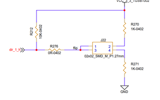

  • HI Nilay,
    Can you confirm that the DIR/FLIP pin operates as intended when changing the orientation of the connector?

  • -Can you confirm that the DIR/FLIP pin operates as intended when changing the orientation of the connector?
    Yes,It will operates as intended when changing the orientation of the connector.

    -How did you measure the 600mVpp vs. the 1.2Vpp. When the device is in pin-strap mode this is a linear redriver meaning that the voltage should be close to 1:1.
    Yes, Our concern is same as you. In pin strap mode, voltage close to 1:1 for linear redriver mode with around 0 dB gain. In our case, the observed output voltage is approximately 1.2V peak-to-peak (VPP), whereas the corresponding input voltage is around 600mV peak-to-peak (VPP).
    So What was possible reason behind that?

    I'm not sure to be honest. There should be no setting that simply doubles the swing we are seeing. What is the method you are using to measure the signal? It may also be worthwhile to swap out this part for another TUSB1104 device to see if the behaviors is consistent.
