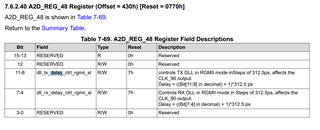

I plan to set internal delay for 100base T1 RGMII and TX and RX delay shall be set at PHY side.
  1. If align mode is used during strap setting, and  cfg_rgmii_rx_clk_shift_sel=1b  cfg_rgmii_tx_clk_shift_sel=1b
what is the RGMII internal delay of TX and RX? only 2 ns? datasheet shows only 2ns.
  1. If  RGMII (TX and RX Internal Delay Mode) is used during strap setting,
    What is the RGMII internal delay of TX and RX? 5 ns? because default setting of below register setting:
dll_tx_delay_ctrl_rgmii_sl: 0xFh(5ns);
dll_rx_delay_ctrl_rgmii_sl: 0xFh(5ns);
  1.  cfg_rgmii_rx_clk_shift_sel  cfg_rgmii_tx_clk_shift_sel describe if set to 1b then there is 90 degree between clk and data.
    1. if RGMII align mode used, then the TX and RXD internal delay is 10ns?
    2. if RGMII (TX and RX Internal Delay Mode) is used, then the TX and RXD internal delay is 15ns?

    Yes, 2 ns because the register value overrides the strap setting.
    No, if you were to set [11:8] and [7:4] to 0xFh the resulting delays would be 5ns. The default delay for each is 2.5ns.
    See an updated datasheet. www.ti.com/.../dp83tc812r-q1.pdf
    Align means -750ps to 750ps on RX and no added delay on TX.
