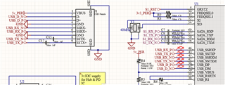

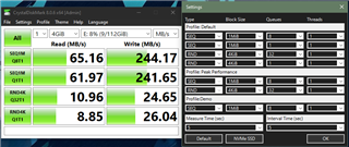

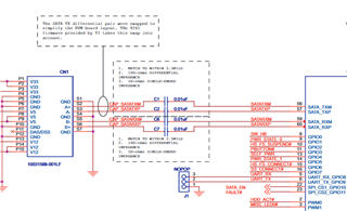

I have designed a module for this USB-SATA Bridge, and during testing, have found that my read speeds are consistently slower than write.
Over USB2, both read and write are consistently around 45MBps (which is consistent with the bus bottleneck), but over USB3 I am seldom able to break 69MBps sequential read.
Example:
I have tried this with several HDDs and SSDs, including one 120GB Samsung 840EVO that consistently hits 250MBps Sequential Read/Write with other bridge adapters (such as JMS578).
Is this an issue with my USB-3 implementation? Is there something i need to tweak in the firmware?
My schematics & firmware are attached (firmware is .bin, changed filetype to upload)

  • Hi Kurt,
    We are looking at your issue and schematic, and will try to get back to you by the EOD tomorrow, 2/28.
    Ryan
  • I think I've identified my issue.
    In my design, the SS Tx lanes have AC coupling caps, where the Rx lanes do not:
    Per the development kit schematic for this chipset, it appears that both Rx and Tx pairs need caps:
    I can add these caps into the next iteration of the design and see if that helps, but I am still confused why these are necessary.
    Most of the other USB3 bridge chipsets that I work with have coupling caps on their Tx pairs, and the assumption is that Rx coupling will be handled by the host's own Tx pair. Is there a specific reason with this chipset that it would require coupling on both ends?
    Edit: Nnnope, misread that one. Cn1 was the SATA connector, which I should have been looking at J2.
    So I'm still at a loss as to why the read rate is so slow.
  • Hi Kurt,
    Sorry for the late reply. From what I can tell, I don't believe the read speed should be this low. I can't find anything on your design, at least right now, that would affect this.
    Is it possible on your side to grab a USB3 protocol trace and see what that reads back, or just confirm it is making that USB3 connection? In the mean time, I will take one of our EVMs on our side and see if I can emulate this, or if I don't see the issue.
    Ryan
  • Dry contact discovered on one of the TX coupling caps during probing. Reflowing this segment resolved the discrepancy, now both Read and Write are equivalent (~250MBps).
    Thank you for your time in confirming the design.
