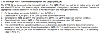

  • Hi Vimal,
    For more information, please refer to this E2E thread (link). See below description from 948 data sheet as well for more details:
    Nikolas
