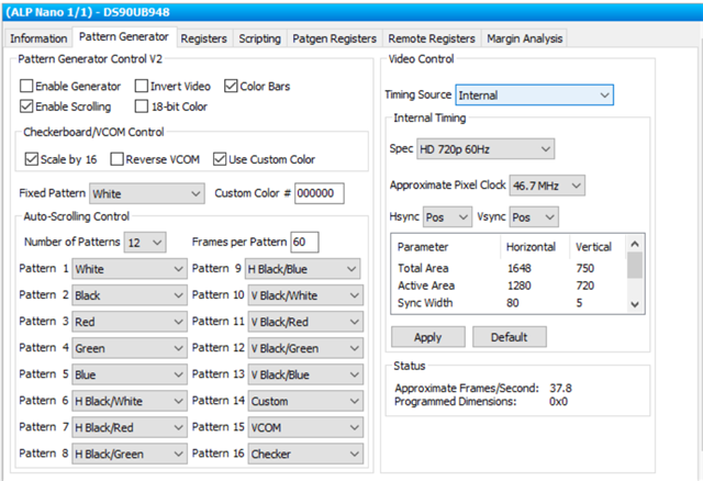

    You and Daniel have stated that the screen shifting behavior was seen with 948 PATGEN as well. How did you program the PATGEN? Were you using internal or external timing?
    There are three main possibilities for why the screen is disrupted during an ESD event
    • Loss of lock
    • 948 voltage rails brownout
    • Excessive noise on OLDI traces
    To monitor for potential loss of lock, register dumps of the SER and DES can be taken before and after the ESD event. Both the "948 voltage rails brownout" and "excessive noise on OLDI traces" would require measurements. Figuring out why ESD is causing the screen disruption will be the best way to stop this behavior.
