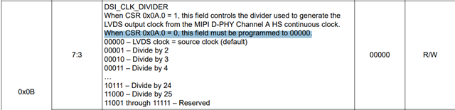

ADDR 0x0B 1:0 bit are the setting for changing FREQ from REFCLK to LVDS CLK
ADDR 0x0B 7:3 bit are the setting for changing FREQ from DSI CLK  to LVDS CLK.

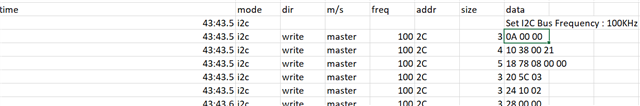

    freq_change20250305.csv
  • Hi Hirobe-san,
    I noticed in the csv file that the value for 0x0A changes, not 0x0B.
    Could you verify that register 0x0B was changed, not 0x0A?
    Also, when you select REFCLK to output LVDS_CLK, you cannot change the value of 0x0B[7:3] from 0b00000 so 0x29 and 0x2A for 0x0B will not be a valid value to guarantee proper behavior of the chip.
    I confirmed my setting was correct.
    This setting occurs this result.

    But I understand that I must keep 0x0B[7:3]=0b00000.

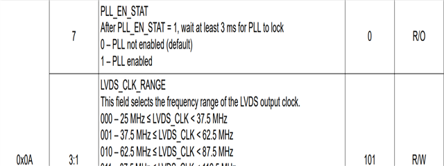

    However, this could be because of 0x0A[3:1] which is the register that sets LVDS_CLK_RANGE. If this is currently set to 0x0A[3:1] = 0b000, this may cause unexpected behavior.

    I followed up internally and they suggest to change the LVDS_CLK_RANGE to see if LVDS_CLK will output 100 MHz given 100 MHz REFCLK with x1 multiplier.
    Note that if multiplier creates LVDS_CLK exceeding 154MHz, there will be undefined behavior on LVDS_CLK. That explains the 16.7 MHz that LVDS_CLK sees when the multiplier goes beyond 2.
