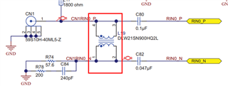

1. Is it necessary to add common mode choke (as below red box)?
2. What impact will it have if add common mode choke?
No, a common mode choke is not required. Common mode chokes can be used in STP configurations to reduce common mode interference, which can be helpful for reducing emissions.
